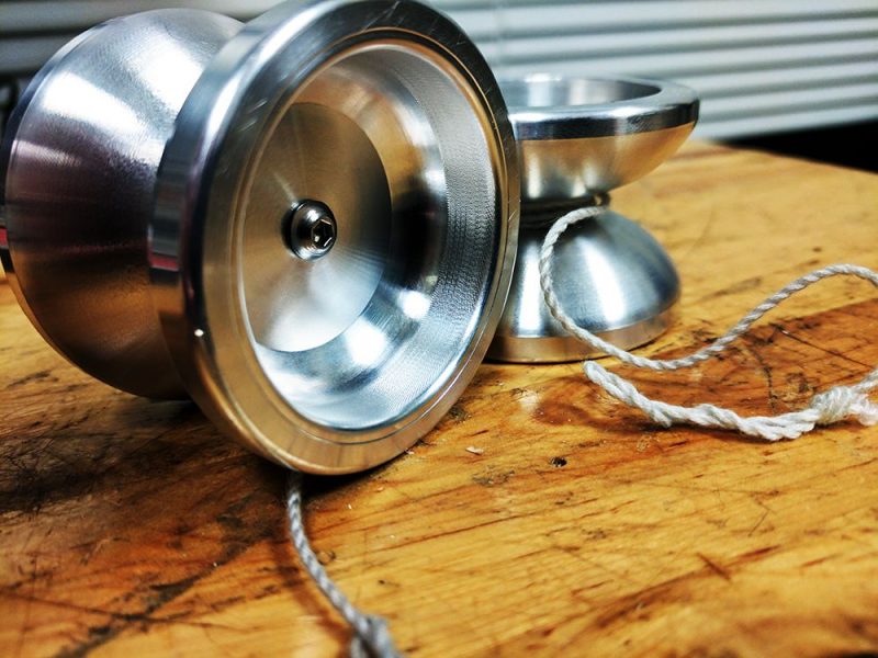

This project will walk you through CNC machining the parts needed to build a modern “butterfly” yo-yo on your Tormach Slant Pro CNC lathe.

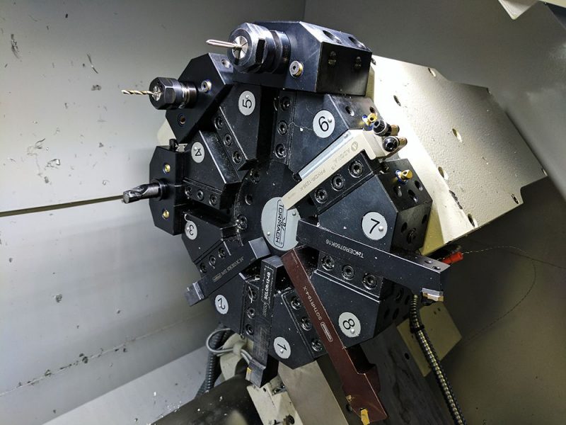

  1. The first step in any project is to come up with a good plan! I designed and prepared the CAD/CAM files needed to make this yo-yo in Fusion 360. The CNC operations that are used to make this yo-yo are separated into two setups. This project uses the Turret on the Tormach Slant-PRO Lathe. You’ll be working on the X+ side of the part with grooving tool and the boring bar. The drill bit and tap work at X-0, and move on the positive side.
  2. Lathe set up for yo-yo project
  3. In this project, we are going to use five tools that need to be loaded into the lathe turret. In the above image, you can see how I installed the tools into the lathe, what tool holders I used and what numbers I put them in to match the machining operations in the fusion 360 CAM file. The tool list is as follows:
    • Tool number 1 is the OD Turning Tool
    • Tool number 3 is the 3/8 in. Right Hand boring bar
    • Tool number 4 is the #30 drill bit
    • Tool number 5 is the 4 mm tap
    • Tool number 8 is the Right-hand grooving tool
    Once the tools are installed into the proper locations on your lathe you will need to touch them all off. Please consult Tormachs video on how to do this:

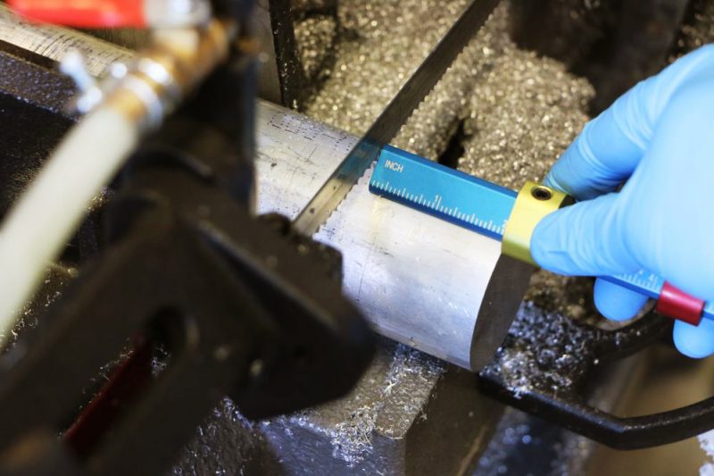

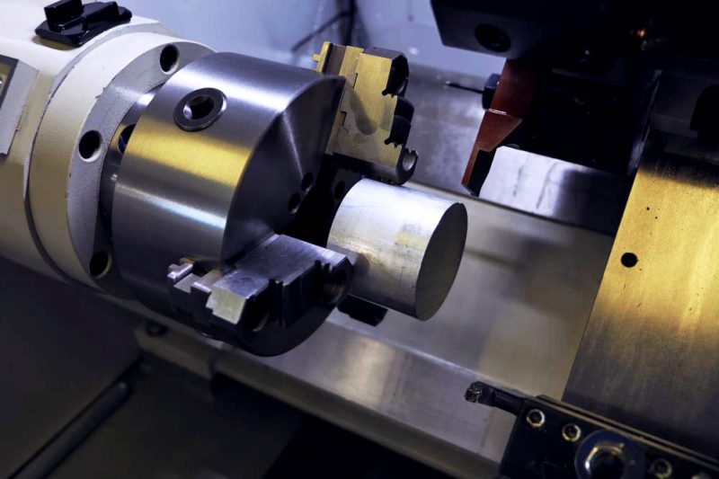

  1. After your tooling is ready to go it is time to prepare the raw material. I used a Stop-Loc to set two measurements. The first one is the gold colored stop, it is set at 2 in. and is used to measure and cut the material to the correct length. The second red colored stop is set to 4 1/8”. The backside of this stop is used to set the stick out of the material in the lathe chuck to the correct length.
measuring aluminum stock for yo-yo project
  1. In this image you can see me using the Stop-Loc to set the length of the 2.5” diameter aluminum round used to make the yo-yo half. This tool makes it easy to cut multiple blanks to the correct length.
using a stop loc tool for proper set up

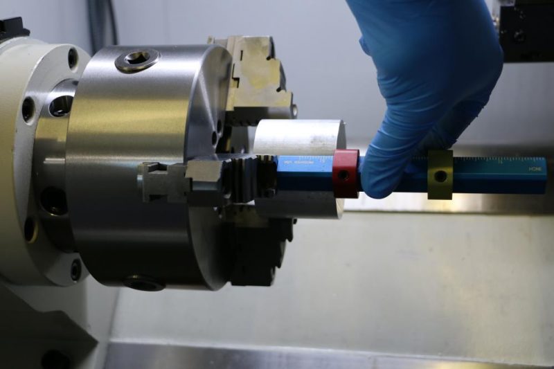

  1. Once my blank was cut out I used the second side of the stop-loc to set the material the correct depth in the three jaw chuck. Having the material stick out the proper length is important to avoid crashes.
bar stock in place for yo-yo project
  1. Once the material is tightened down in the lathe you will need to use the parting tool to face it off and set the machine Z axis to zero. You should already have all of the other tools properly touched off at this point. It is now time to load setup one from Fusion 360 into Path Pilot and get cutting.

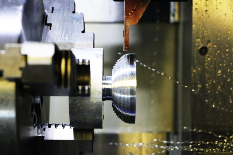

yo-yo being cut on Tormach lathe
  1. The final tool is tool number eight, the right-hand grooving tool. First it will cut several roughing passes, leaving the yo-yo with a stepped look.

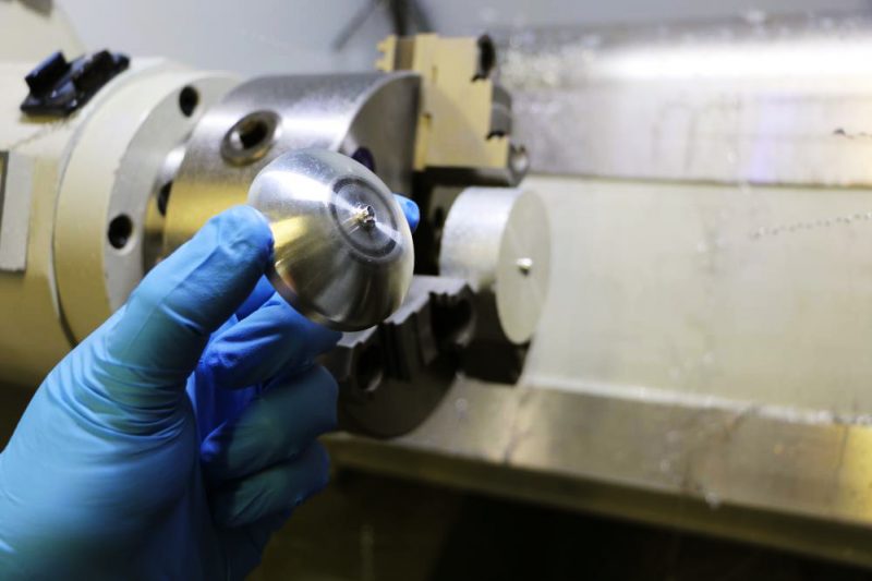

first half of yo-yo finished
  1. Once the roughing passes are complete, the lathe goes back and starts running the finishing passes. First it smooths the steps away, then it cuts the last few features into the back of the yo-yo, and finally it parts it off. A small Pip will be left on the back side of the yo-yo that will need to be filed or sanded away.
  2. Once you have machined the first half of your yo-yo you will need to go back to the beginning and do it again. When you have the second half complete, you are ready to assemble!

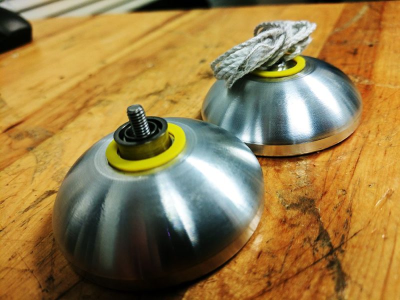

  4. To start assembly, first peel the backing off the self-adhesive response pads and stick them on each half of the yo-yo. Try to position them as close to concentric as possible. These help the yo-yo to bind and re-wind when you attempt to pull it back to you.
putting your yo-yo together - made on a Tormach lathe
  1. Once the response pads are in place you will then need to install the center shaft, bearing, and string. The M4 threaded center shaft is first threaded into place. Then you press the bearing onto the shoulder on the back of the yo-yo. Once the bearing is in place untwist the very end of the yo-yo string to create a loop and place it over the bearing.
  2. The last step to finishing your new yo-yo is to take the second half and screw it onto the half that you just assembled. Your new yo-yo is now ready to play with and customize!
