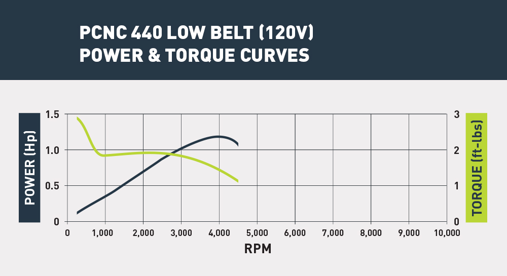

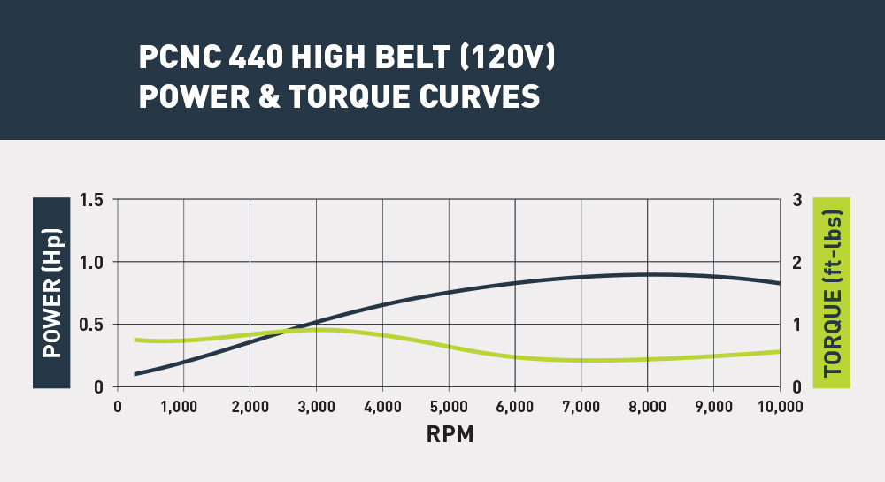

How To Read a Spindle Motor Torque, Power, and Duration Chart
Optimizing your machining processes is essential for achieving the best performance from your equipment. Among the various factors that contribute to this optimization is understanding how to read and use a spindle motor torque, power, and duration chart.
This guide will help you navigate these charts, ensuring you make informed decisions for your machining operations.

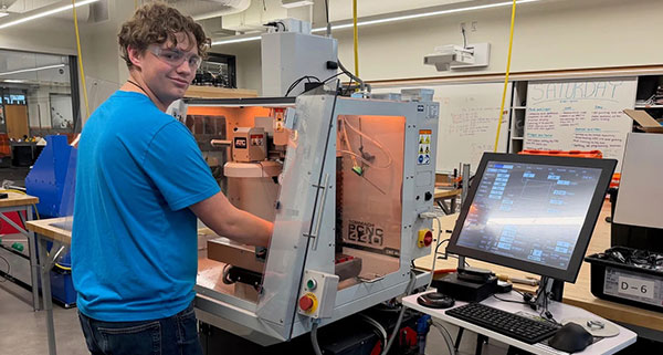

Kenwick High School uses a PCNC 440 as a part of their CNC training programKenwick High School uses a PCNC 440 as a part of their CNC training program
Building a High School Manufacturing Program
Kennewick High School uses the PCNC 440 to give students hands‑on experience with real machining and manufacturing.
