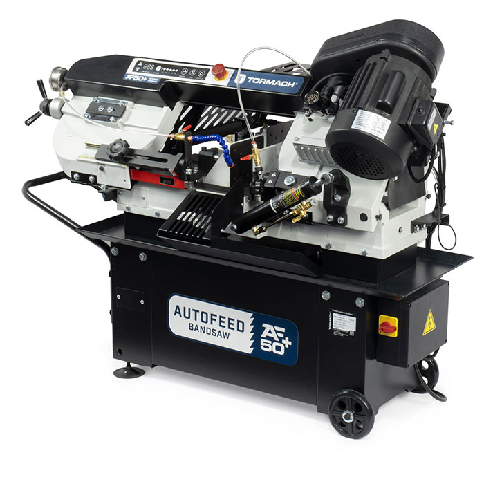

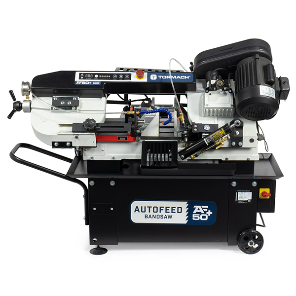

AF50+ TECHNICAL SPECIFICATIONS
Capacity
Max material weight: 250lbs
7 in (178 mm) Round / 6 in x 8 in (152 mm x 203 mm) Flat at 90 degrees
Table Height: 21.75 in. / 552 mm
Length: 50 in. / 1270 mm
Width: 36 in. / 914 mm
Height with Saw at Rest: 36 in. / 914 mm
Height with Saw Vertical: 67 in. / 1702 mm
Motor Power: 1 hp / 0.75 kW
Blade Speed
60 Hz: 90, 134, 195, 255 ft/min(27, 41, 59, 78 m/min)
50 Hz: 70, 110, 160, 210 ft/min(22, 34, 49, 64 m/min)
Blade Size
Blade Length 93 in. (2362 mm)
Blade Width 0.75 in. (19 mm)
Blade Thickness 0.035 in. (0.9 mm)
Features
115 Vac, Single-Phase Power
Pneumatic Clamping System
Hydraulic Feed Control
Programmable Automatic Workpiece Positioning
Cut length: 0.157 in – 50 in (4 mm – 1270 mm)
Maximum 999 parts per program
Part countdown display
Integrated Coolant System — Tank capacity 2.65 Gal (10L)
Recycles Coolant
Portable
4 Blade Speeds
Blade Tensioning System
Warranty
1 Year Warranty against defects in material and workmanship.

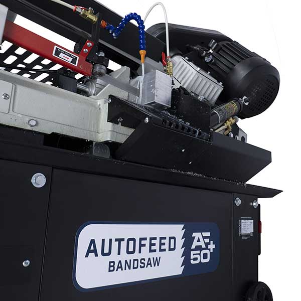

CUT SMARTER WITH THE AF50+ BANDSAW
The AF50+ Autofeed Bandsaw is a compact, powerful cutting solution that runs on single-phase power and 90–120 PSI compressed air. With a 1-horsepower motor and 93 in. blade, it cuts stock from 0.157 in. up to 50 in., including 6 x 8 in. rectangular and 7 in. round profiles.
Key features include four blade speeds, adjustable clamping pressure, drop rate, material feed speed, and a 2.6-gallon recirculating coolant system. For larger parts, it supports multi-stroke programming to extend cutting capacity.
