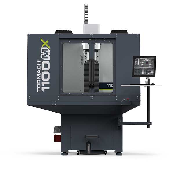

1100MX Essentials Package
1100MX
Configurable packages starting at: $29,594

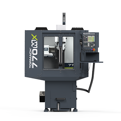

770MX mill
770MX
Configurable packages starting at: $24,950

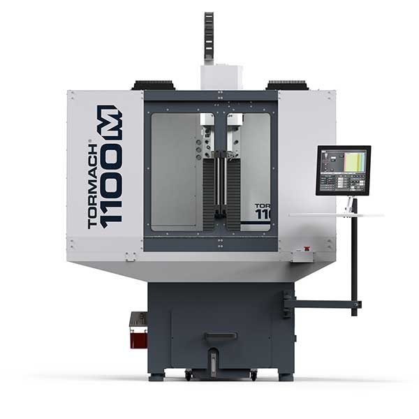

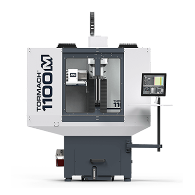

1100M Essentials Package
1100M
Configurable packages starting at: $15,231

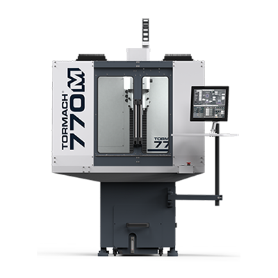

770M CNC Milling Machine
770M
Configurable packages starting at: $12,485

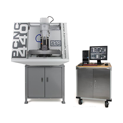

PCNC440 CNC Milling Machine
PCNC 440
Configurable packages starting at: $9,050

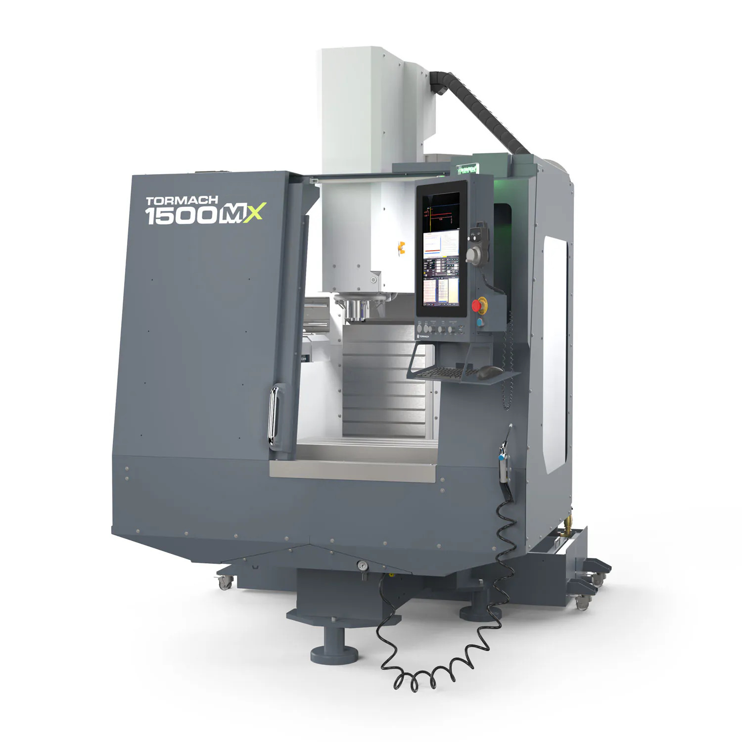

1500MX CNC Mill
Configurable packages starting at: $35,450
Travels:
X-Axis: 19.7 in. (500 mm)
Y-Axis: 13.8 in. (350 mm)
Z-Axis:  14 in. (356 mm)
Spindle:
Power: Continuous power: 4 hp (3 kW)/ Peak Power: 6 hp (4.5 kW)
Maximum Speed:10,000 RPM
Transmission: Synchronous Belt
Spindle Taper: BT30
Threading: Rigid Tapping, Tension/Compression, Thread Mill
Maximum Feed Rate:
X- and Y-Axis: 1200 IPM (30.5 m/min)
Z-Axis: 600 IPM (15.2 m/min)
Axis Motor: 23-bit Absolute Encoder Servo Driven
Power:
Power Required: Single-Phase 230 Vac, 50/60 Hz, 30A breaker
Machine Specifications:
Table Size: 35 in. × 12.75 in.
Table Slots: 5/8 in. (three slots)
Spindle to Table Max Clearance: 17.7 in.
Typical System Weight: 2800 lbs.

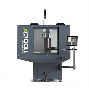

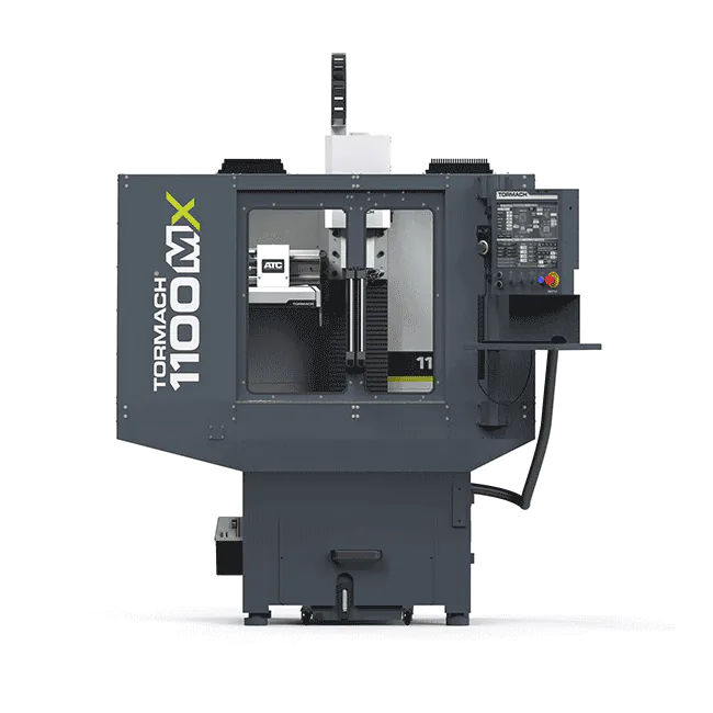

1100MX CNC Mill
Travels:
X-Axis: 18 in. (457 mm)
Y-Axis: 11 in. (279 mm)
Z-Axis: 16.25 in. (413 mm)
Spindle:
Power: 2 hp (1.49 kW)
Transmission: Poly-V Belt
Spindle Taper: BT30
Maximum Feed Rate:
X- and Y-Axis: 300 IPM (7.62 m/min)
Z-Axis: 230 IPM (5.84 m/min)
Axis Motor: Servo Driven
Power:
Power Required: Single-Phase 230 Vac, 50/60 Hz, 20A breaker
Table Size: 34 in. × 9.5 in.
Spindle to Table Max Clearance: 17.25 in.
Typical System Weight: 1850 lbs.

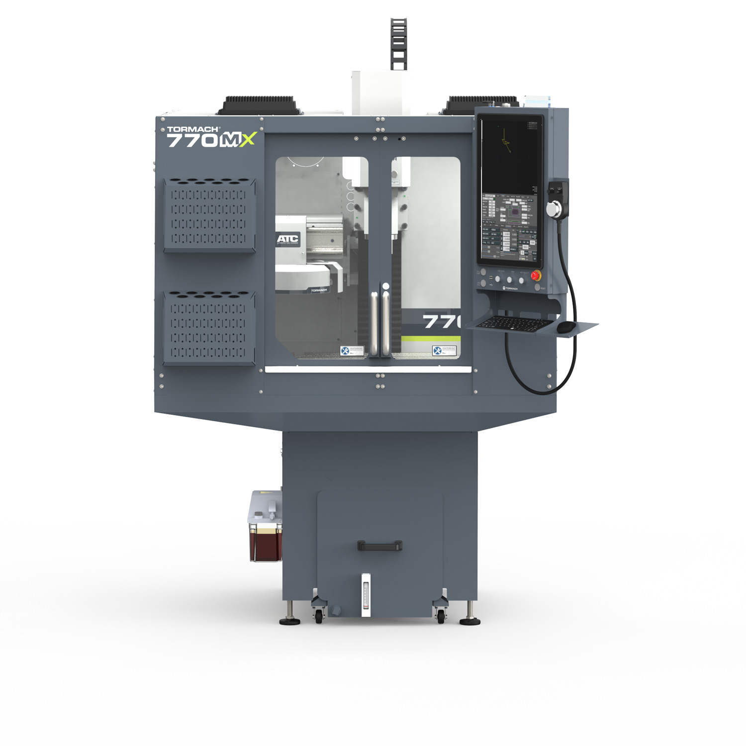

770MX CNC Mill
Travels:
X-Axis: 14 in. (356 mm)
Y-Axis: 7.5 in. (191 mm)
Z-Axis: 13.25 in. (337 mm)
Spindle:
Power: Continuous power: 2 hp / 1.49 kW
Spindle Taper: BT30
Maximum Feed Rate:
X- and Y-Axis: 450 IPM (11.4 m/min)
Z-Axis: 420 IPM (10.6 m/min)
Power:
Power Required: Single-Phase, 230 VAC*, 20A breaker *±10%, best performance at 240 vac
Table Size: 26 in. × 8 in.
Spindle to Table Max Clearance: 13.75 in.
Typical System Weight: 1500 lbs.

1100MX/M
Typical System Footprint: 69 in. × 56.5 in.
(1753 mm x 1435 mm)

770M
Typical System Footprint: 56 in. × 48.5 in.
(1422 mm x 1232 mm)

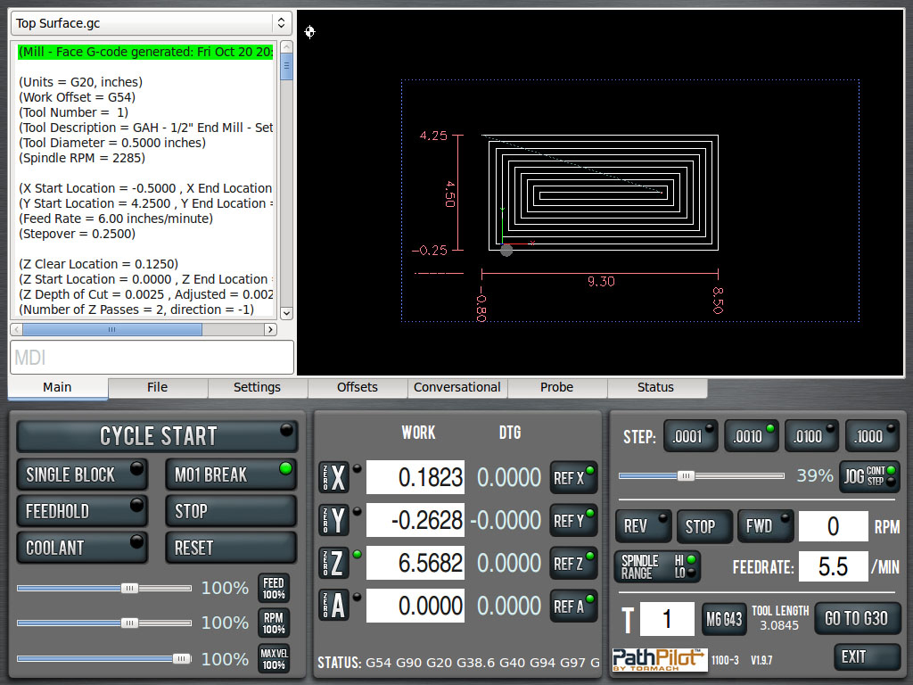

WHAT IS PathPilot HUB?
Ready to master CNC programming? PathPilot HUB is a cloud-based, full-featured simulator designed for Tormach users and CNC beginners alike. Explore PathPilot’s intuitive interface, perfect your skills, and test G-code—all without touching a machine.
More than just a learning tool, PathPilot HUB empowers Tormach owners to create and validate real-world CNC programs remotely. Develop and debug G-code from your office or home, saving valuable shop floor time. Once your program is ready, download it directly from the web interface and run it on your Tormach machine with confidence.
Best of all, it’s free! Start programming smarter today with PathPilot HUB.

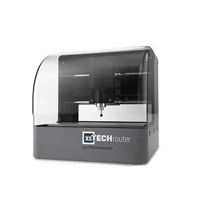

xsTECH Pro CNC Router/Mill
xsTECH Pro
Configurable packages starting at: $10,795
xsTECH CNC Router/Mill
xsTECH
Configurable packages starting at: $4,535

OUR NEW 1500MX CNC MILL
This machine is in a class of it's own in our lineup. The 1500MX was designed with production and automation in mind; here are some of the features that you might make use of.
FEATURES WE THINK YOU WILL BE MOST EXCITED ABOUT
  • Absolute encoded axis servos means you never have to worry about losing your position or homing axis at start. Just power up and pick up where you left off.
  • Epoxy granite frame: 10x the dampening capabilities of cast iron and made in the USA.
  • 4HP spindle (6HP peak.)
  • Wireless probing and tool setting.
  • Many more features and options to suit your needs.

xsTECh
xsTECH
Ready-to-run tabletop router/mill: $4,535

M vs MX - What Is The Difference?
  • SPEED:
    Rapid Speeds - 1100MX and 770MX boast 300 inches per minute (IPM) rapid speeds, while PCNC and M series machines boast rapid speeds of 110-135 (IPM).
    Cycle Times - Generally speaking, the MX machines have 20% faster cycle times (varies based on tool path and part geometry).
  • MOTION CONTROL:
    Stepper Drive Motors - Stepper motors have no positional feedback loop. When the controller tells an axis to move, it’s assumed the motor in fact moves that much. The only time you are in real danger of losing position with a stepper motor in our machines is if you crash or stall your machine.
    Servo Drive Motors - Servo motors provide positional feedback. When the controller calls for an axis to move, then the motor sends positional feedback, verifying it’s where it should be. This allows for crash detection, much higher rapid speeds and more accurate homing. See machine specs for the speed capabilities of each machine.
  • SPINDLE:
    BT30 - MX machines have a BT30 spindle, which is an industry-standard tapered tool holder with a 45 degree pull stud and drive dogs. This combination allows for a more rigid connection between the spindle and the tool and reducing the risk of tool pull-out. In addition, this is an encoded spindle, giving the controller awareness of position, allowing for rigid tapping.
    TTS - PCNC and M machines have an R8 collet in the spindle and use TTS tool holders. This is a 3/4” straight shank tool holder that is proprietary to Tormach.
Mill Comparison Guide
1100M | 1100MX
770M | 770MX
PCNC 440
Travels
X-Axis: 18 in. (457 mm) 14 in. (356 mm) 10 in. (254 mm)
Y-Axis: 11 in. (279 mm) 7.5 in. (191 mm) 6.25 in. (159 mm)
Z-Axis: 16.25 in. (413 mm) 13.25 in. (337 mm) 10 in. (254 mm)
Spindle
Spindle Power: 2 hp (1.49 kW) 1.5 hp (1.12 kW) 0.75 hp (0.56 kW)
Maximum Speed: 7500 RPM (1100M) | 10,000 RPM (1100MX) 10,000 RPM 10,000 RPM
Transmission: Poly-V Belt Poly-V Belt Poly-V Belt
Spindle Taper: R8 (1100M)| BT30 (1100MX) R8 (770M)| BT30 (770MX) R8
Spindle Taper: Tension/Compression, Auto-Reversing, Thread Mill (1100M)
Rigid Tapping, Tension/Compression, Thread Mill (1100MX)
Tension/Compression, Auto-Reversing, Thread Mill (770M)
Rigid Tapping, Tension/Compression, Thread Mill (770MX)
Thread Mill
Maximum Feed Rate
X- and Y-Axis: 110 IPM (2.79 m/min)(1100M)
300 IPM (7.62 m/min) (1100MX)
135 IPM (3.43 m/min) (770M)
300 IPM (7.62 m/min) (770MX)
Z-Axis: 90 IPM (2.29 m/min)(1100M)
230 IPM (5.84 m/min)(1100MX)
110 IPM (770M)
250 IPM (6.35 m/min)(770MX)
Axis Motor: Stepper Driven (1100M)
Servo Driven (1100MX)
Stepper Driven (770M)
Servo Driven (770MX)
Stepper Driven
Power
Power Required: Single-Phase 230 Vac, 50/60 Hz, 20A breaker Single-Phase 115 Vac, 50/60 Hz, 15A breaker Single-Phase 115 Vac,50/60 Hz, 15A breaker
Table Size: 34 in. × 9.5 in. (863 mm × 241 mm) 26 in. × 8 in. (660 mm × 203 mm) 18 in. × 6.3 in. (457 mm × 160 mm)
Table Slots: 5/8 in. (15.9 mm)(three slots) 5/8 in. (15.9 mm) (three slots) 3/8 in. (9.5 mm)(three slots)
Spindle Nose to Table Max Clearance: 18 in. (457 mm)(1100M)
17.25 in. (438 mm)(1100MX)
14.25 in. (362 mm)(770M)
13.75 in. (349 mm) (770MX)
12 in. (305 mm)
Spindle Centerline to Machine Column: 11 in. (279 mm) 8.6 in. (218 mm) 6.5 in. (165 mm)
Machine Size: 69 in. × 56.5 in. (1.8m × 1.4 m) 56 in. × 48.5 in. (1.4m × 1.2 m) 42 in. × 36 in. (1.1m × 0.8 m)
Overall System Height: 96 in. (2.4 m) 88 in. (2.2 m) 70 in. (1.8 m)
Typical System Weight: 1600 lb. (726 kg) 950 lb. (431 kg) 600 lb. (272 kg)
