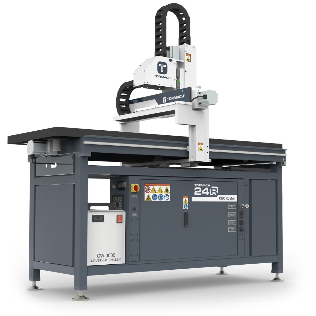

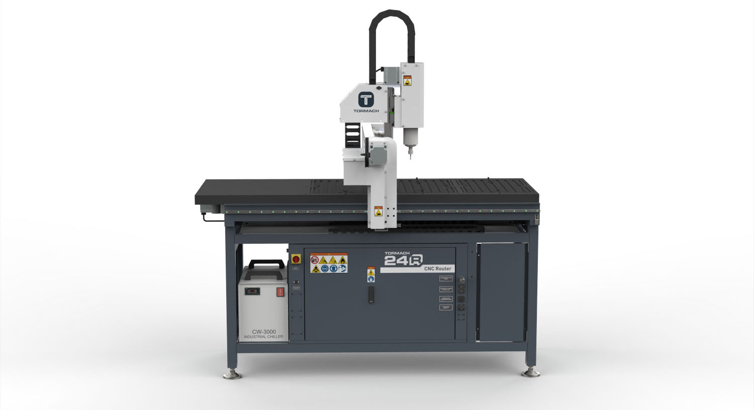

24R CNC ROUTER TECHNICAL SPECIFICATIONS
Travels
X-Axis: 24.75 in. (625 mm)
Y-Axis: 55.75 in. (1415 mm)
Z-Axis: 6.70 in. (170 mm)
Spindle
Spindle Power: 2 hp / 1.5 kW
Spindle Type: Electrospindle
Minimum Speed: 10,000 RPM
Maximum Speed: 24,000 RPM
Cooling: Water-Cooled (Chiller Included)
Spindle Taper: Stock - ER20 / With ATC - ISO20
Thread Machining: Thread Mill
Power Required
24R CNC Router: Single-Phase 115 Vac, 50/60 Hz, 15A breaker
Storm Vacuum Pump for 24R: Single-Phase 220-240 Vac / 20A breaker
Machine Specs
Table Type: Integrated Vacuum Table
Table Size: 26.5 in. x 65 in. (680 mm x 1650 mm)
Gantry Clearance: 6 in. (154 mm)
Machine Footprint: 72 in. × 39 in. (1.8 m × 1 m)
Overall System Height: 76.5 in. (1.9 m)
Typical System Weight: 900 lb (408 kg)
Linear Motion
Axis Motion: Ballscrew and Stepper Driver
Maximum Feed Rate: 200 IPM (5.0 m/min)
Construction
Stand: Welded Steel (Included)
Machine Base: Cast Iron
Gantry: Aluminum
Resolution & Accuracy
Resolution: 0.00025 in. (0.006 mm)
Ball Screw Positional Accuracy: ±0.002 in./ft. (±0.167 mm/m)
Repeatability: ±0.001 in. (±0.02 mm)
Certificate of Inspection: Download Example Here

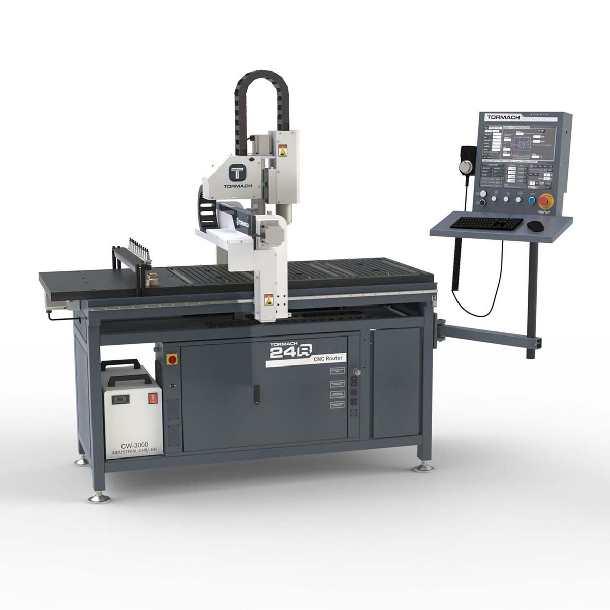

UPGRADE TO THE PATHPILOT OPERATOR CONSOLE
Now available in 24R CNC Router packages, our comprehensive PathPilot Operator Console offers you additional features for enhanced 24R operation. It features integrated hardware knobs for feed and speed adjustments, along with a durable handheld jog pendant for accurate manual machine positioning.

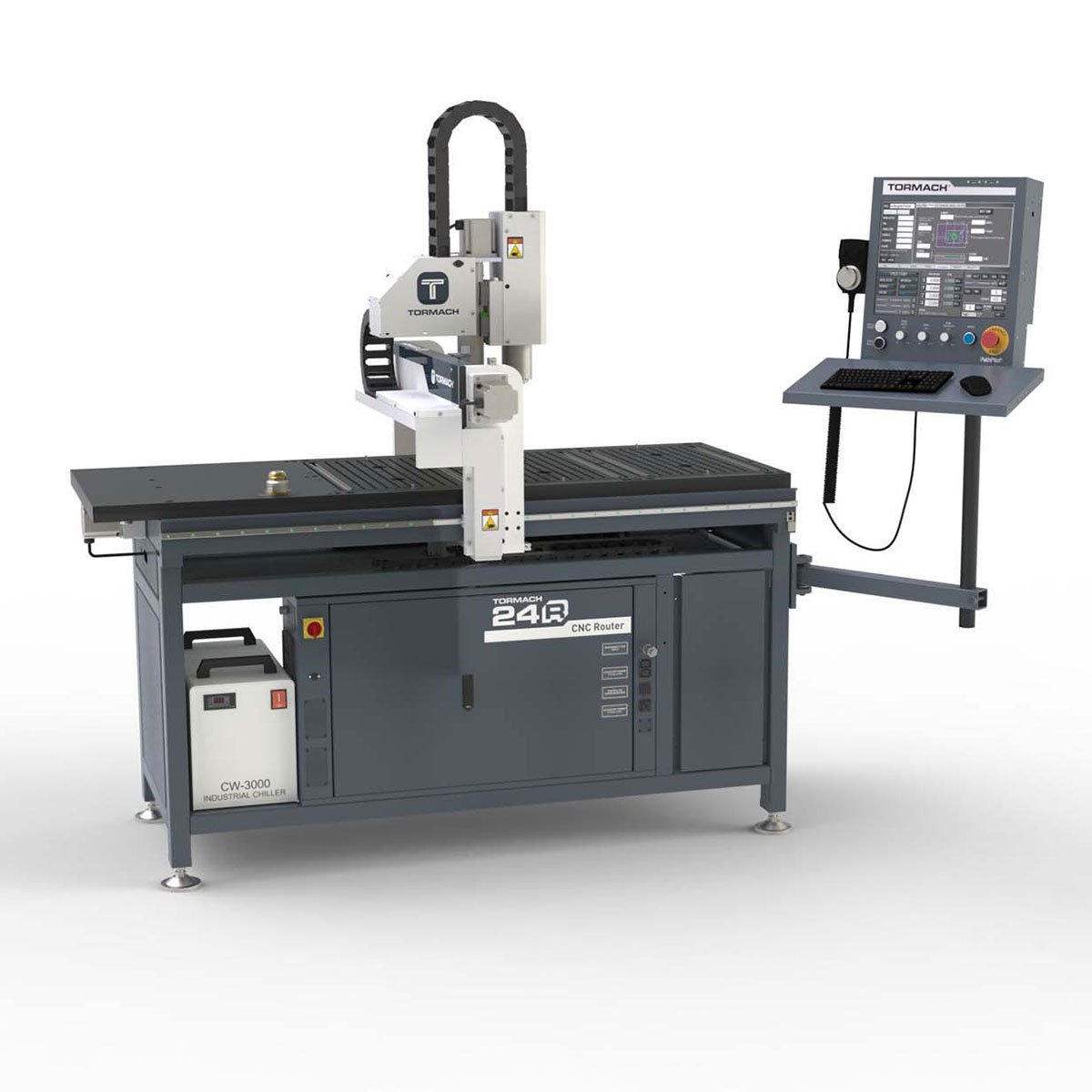

EASY-TO-USE 2x4 CNC ROUTER
The 24R’s table is 26.7 in. x 65 in., with a gantry clearance of 6 in., and includes an integrated vacuum table. It's also powered by single-phase 115 Vac., so it can fit easily in just about every shop.
This CNC Router also includes Tormach’s free and easy-to-use control software, PathPilot®. PathPilot gives you much more control at your fingertips including editing G-code within the user-friendly interface. It also gives you 3D tool path preview, automatic spindle speed control, and more.
