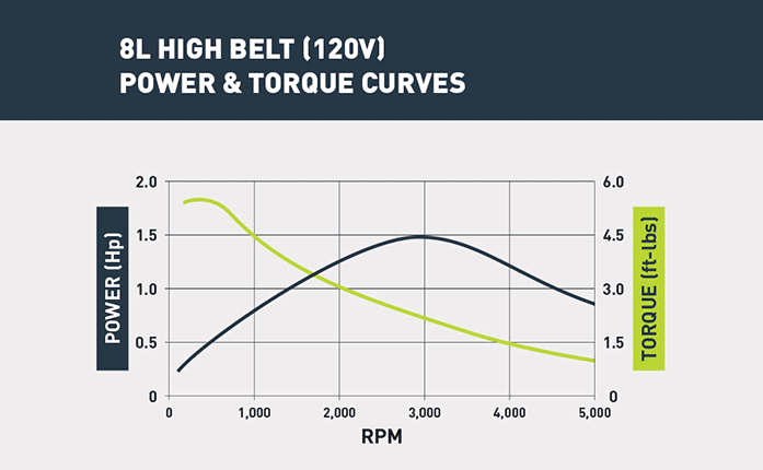

8L Torque Chart8L Torque Chart
How to Read a Spindle Motor Torque, Power, and Duration Chart
Optimizing your machining processes is essential for achieving the best performance from your equipment. Among the various factors that contribute to this optimization is understanding how to read and use a spindle motor torque, power, and duration chart. This guide will help you navigate these charts, ensuring you make informed decisions for your machining operations.

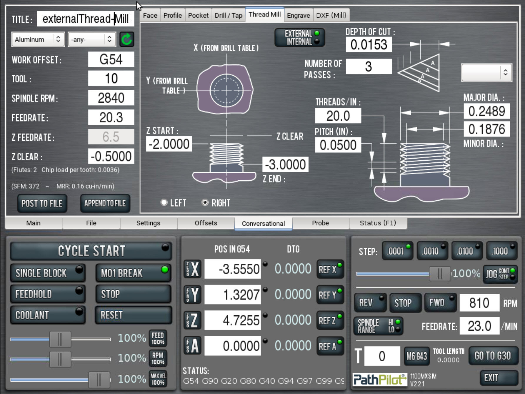

EASY-TO-USE PATHPILOT CONTROL SOFTWARE
PathPilot® is the exclusive CNC controller of Tormach and is included on all machines for free. PathPilot features easy-to-use conversational software that allows you to edit programs on the fly. You can sharpen your programming skills on the PathPilot HUB, which allows you to test out PathPilot online. Learn how to program and create usable G-Code. Log in today to create your free membership.

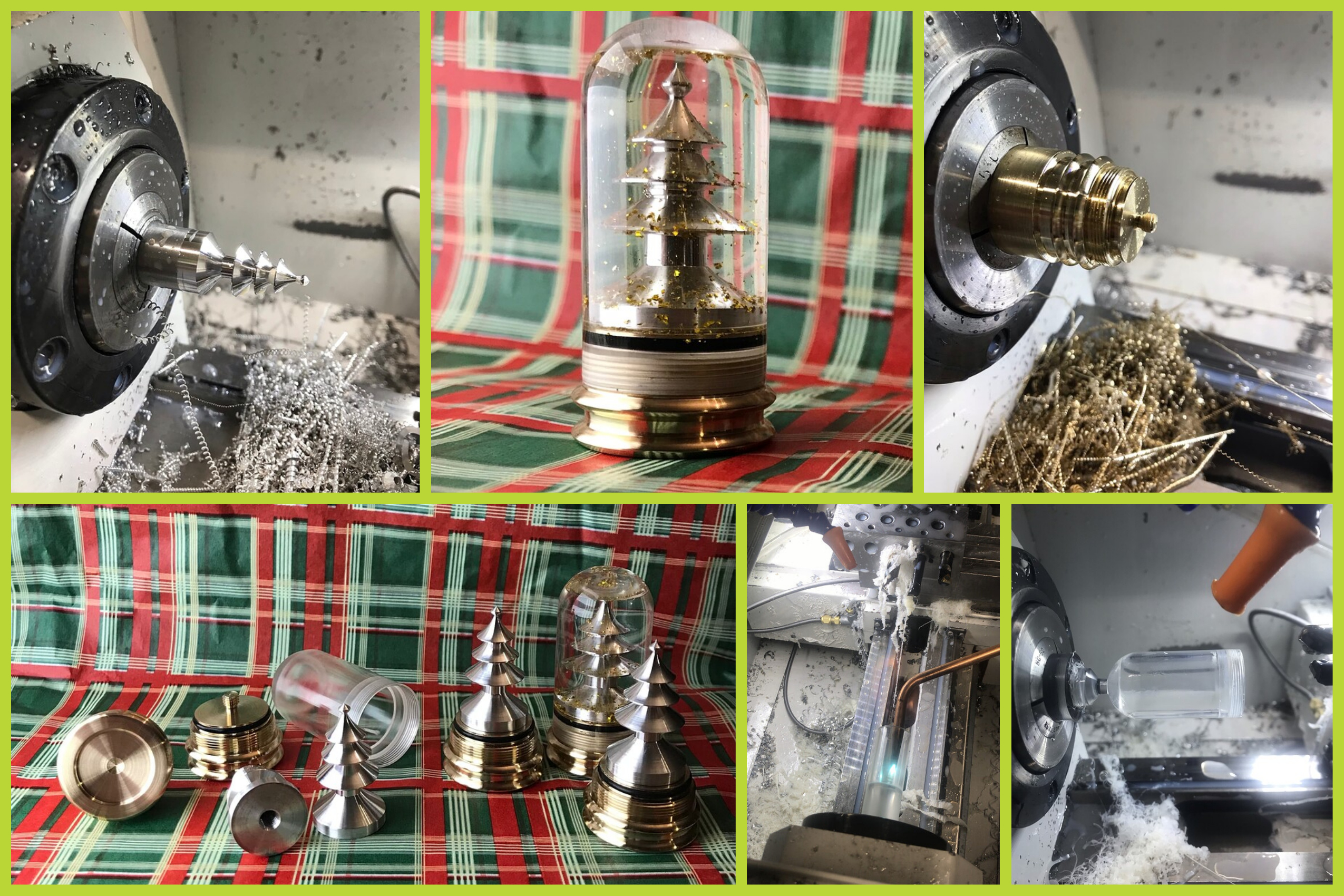

Chris Zajic snow globe
Check out this great Forum Post from Chris Zajic on his Snow Globe project.

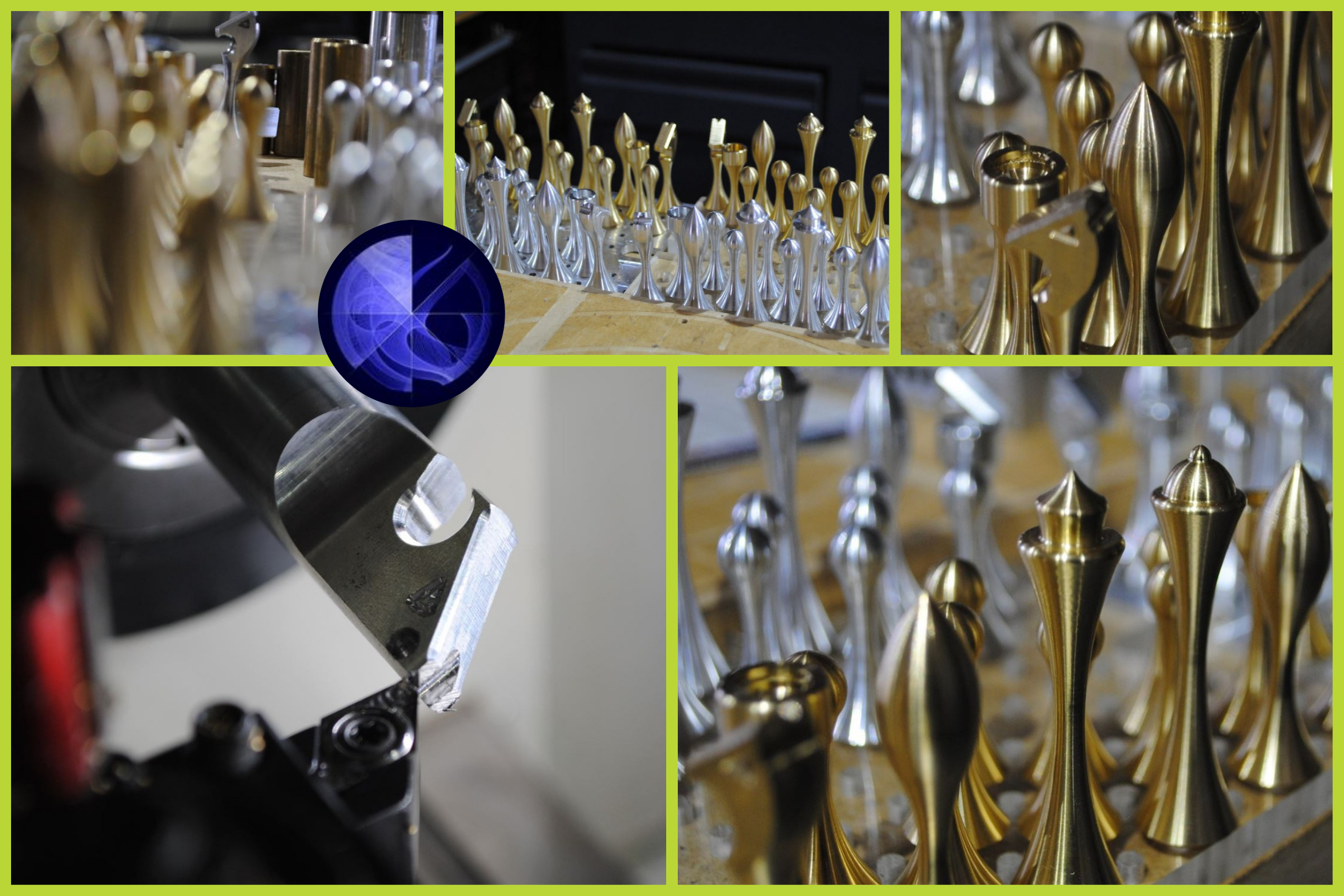

How is an instrument maker using the 8L CNC lathe?
"I was worried about how rigid the 8L was going to be, and how it was going to cut. On a 0.050” cut at 2,500 RPM, I had a pretty nice finish just for roughing, but when I got it set up for finishing, it was like a freaking mirror! I have to say, the finish that I’m getting on the 8L is outstanding."
— Jeff Gittleson, Long Island Brass Co.
INSTRUMENT MAKER USES 8L CNC LATHE TO BUILD HIS BUSINESS
