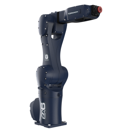

Tormach's ZA6 Industrial Robot
ZA6: 6kg Payload Industrial Robot

Weight: 146 lbs (65 kg)
Payload: 13 lbs.(6 kg)
Reach: 38 in.(975 mm)
Flange Bolt: 6 bolts (M4)
Control Box: 26 in. × 32 in. × 14 in.(650 mm × 820 mm × 360 mm)
Digital Inputs: 16 (14 user inputs, 2 dedicated safety inputs)
Digital Outputs: 16
Joint Ranges and Speeds
Joint 1: Range: ±148° Speed: 150° s-1
Joint 2: Range: +135° to -100°Speed: 112.5° s-1
Joint 3: Range: +65° to -210° Speed: 150° s-1
Joint 4: Range: ± 149° Speed: 204.5° s-1
Joint 5: Range: ± 143° Speed: 225° s-1
Joint 6: Range: ± 360° Speed: 225° s-1
Repeatability
± 0.020 in (0.5 mm)
Power
I/O POWER SUPPLY: 24 Volt 2 Amp
POWER SUPPLY: 200 - 240 Vac, 50 - 60 Hz Single-Phase Power
Noise
Comparatively noiseless
IP Classification
IP65
Programming
Teachmode programming through PathPilot GUI,Python

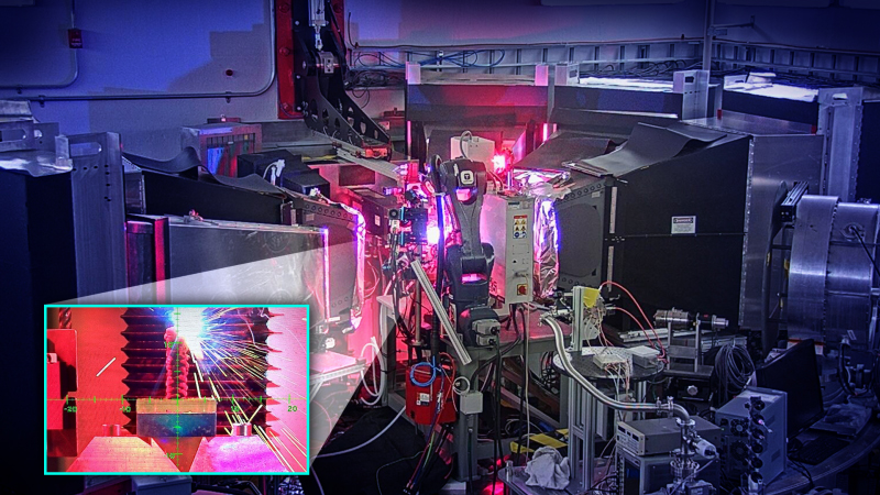

The OpeN-AM experimental platform, installed at the VULCAN instrument, features a Tormach ZA6 robotic arm that prints layers of molten metal to create complex shapes. Studying the 3D-printed welds microscopically with beams of neutrons allows researchers to better understand factors such as stress caused by heating and cooling. The experiments will help to optimize the fabrication technique for more mainstream use. (Credit: ORNL/Jill Hemman)
