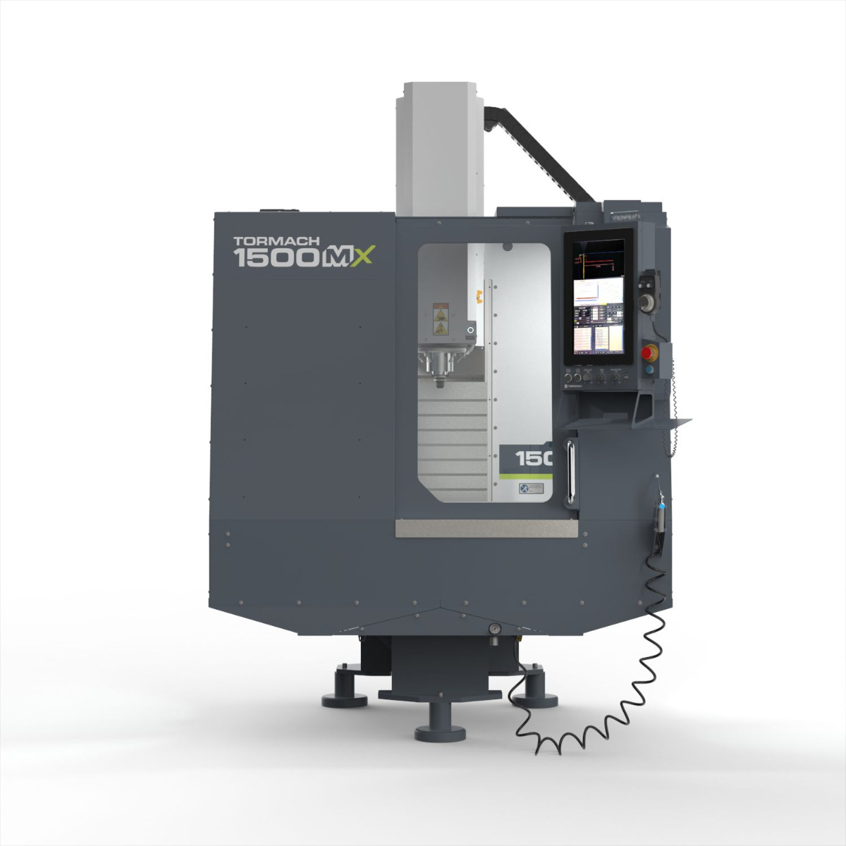

1500MX CNC MILL TECHNICAL SPECIFICATIONS
Travels
X-Axis: 19.7 in. (500 mm)
Y-Axis: 13.8 in. (350 mm)
Z-Axis: 14 in. (356 mm)
Spindle Nose to Table: 3.7-17.7 in. (96-450 mm)
Spindle
Continuous Power: 4 hp (3 kW)
Peak Power: 6hp (4.5 kW)
Spindle Speed: 250-10,000 RPM
Spindle Taper: BT30 (sealed bearing)
Thread Machining: Rigid Tapping
Maximum Feed Rates
X- and Y-Axis: 1,200 IPM (30.5 m/min)
Z-Axis: 600 IPM (15.2 m/min)
Power and Air
Power Required: Single-Phase 230 Vac*, 50/60 Hz, 30A breaker**
Plug Type: NEMA L6-30P
Air Required: 90-120 psi
*±10%, best performance at 240 vac, **Additonal outlets may be required for optional accessories
Table Size: 35 in. × 12.75 in. (0.9 m × 0.3 m)
Typical System Footprint: 86 in. × 104 in. × 94 in.(2.2 m × 2.6 m × 2.4 m)
Typical System weight: 2800 lbs. (1270 kg)
Maximum Weight on Table: 300 lbs. (136 kg)
Performance
Testing: Ballbar testing on every machine
Key Components
Frame: Bonded epoxy granite base and column castings
Ways: Linear rails
Motion System: EtherCAT control system
Shipping
Pallet Weight: Factory Assembled: 3210 lbs. (1456 kg) / Self Assembled: 2650 lbs. (1202 kg)
Crate Dimensions: Factory Assembled: 67 in.(D) × 73.25 in.(W) × 85 in.(H) (1.7 m × 1.86 m × 2.16 m) / Self Assembled: 61.5 in.(D) × 57 in.(W) × 86 in.(H)(1.56 m × 1.45 m × 2.18 m)

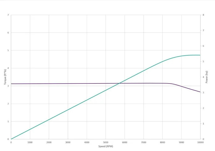

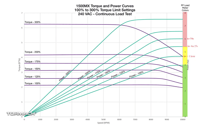

HOW TO READ A SPINDLE MOTOR TORQUE, POWER, AND DURATION CHART
Optimizing your machining processes is essential for achieving the best performance from your equipment. Among the various factors that contribute to this optimization is understanding how to read and use a spindle motor torque, power, and duration chart.
This guide will help you navigate these charts, ensuring you make informed decisions for your machining operations.

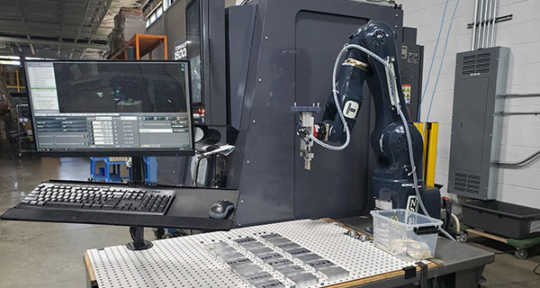

Parker Medical uses a 1500MX CNC mill and a ZA6 robot for automationParker Medical uses a 1500MX CNC mill and a ZA6 robot for automation
Parker Medical Automates Production with the 1500MX
Parker Medical combines the 1500MX and a ZA6 robot to automate machining and boost production of medical components.
