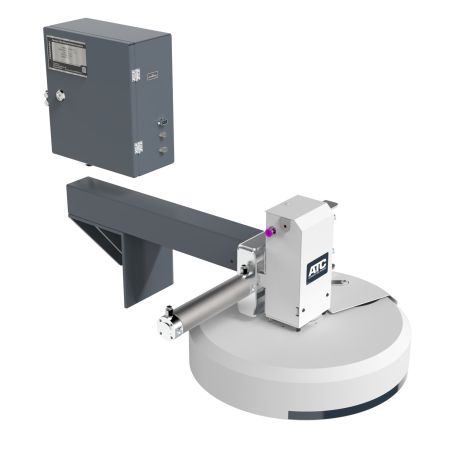

16-pocket automatic tool changer (ATC)

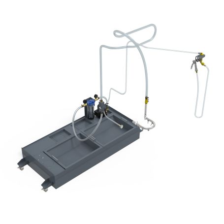

36-gallon flood coolant tank and manual sprayer
