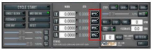

      2. Verify that the machine can freely move to its reference position. Do this by referencing the Z-axis first by hitting REF Z in the PathPilot interface. Then do the same with the X and Y axes. The REF buttons will have a green indicator when their corresponding axis has been referenced.
      3. This process establishes a known position for the PathPilot controller. It gives your machine a starting point of reference for the coordinate system. Essentially, it is the baseline in which all of your other CNC instructions will be based.

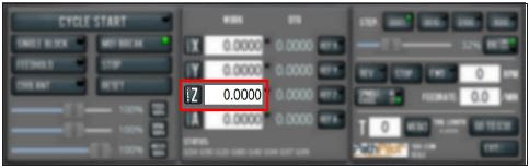

Set the Z Zero
      1. If there's already a tool in the spindle, remove it.
      2. Use a marker to mark the approximate center of the workpiece.
      3. From the PathPilot interface, in the Tool DRO field, type 0. Then select the Enter key.

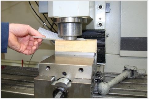

      4. Slowly jog the Z-axis down (-Z) until it's 0.04 in. (1 mm) from the workpiece.
      5. Put a piece of paper on the workpiece.
      6. Slowly jog the Z-axis down (-Z), and slowly move the piece of paper back-and-forth.
      7. Stop jogging the Z-axis when you feel a light pull on the piece of paper, which indicates that it is in contact with the spindle.
      8. From the PathPilot interface, in the Z-axis work offset DRO field, type the thickness of the piece of paper. Then select the Enter key.
    Set to zero

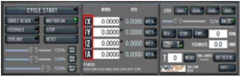

Set the X/Y Zeroes
      1. Put tool 1 (the 3/8-in. end mill) into the spindle.
      2. Jog the tool so that it's close to the mark you put on the workpiece.
      3. From the PathPilot interface, select Zero X. Then, select Zero Y.

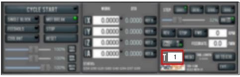

      1. Make sure that tool 1 (the 3/8 in. end mill) is in the spindle.
      2. In the Tool DRO field, type 1. Then, select M6 G43. This tells the machine that you've changed tools, and want to apply the tool length offset.

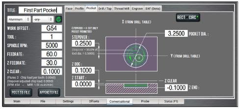

Create a Pocket
      1. Our pocket will be 0.100 in. deep (read by machinists as one hundred thou) and 3-1/4 in. in diameter.
      2. Put tool 1 (the 3/8 in. end mill) into the spindle.
      3. From the PathPilot interface, in the Tool DRO field, type 1. Then select the Enter key.
      4. From the Conversational tab, select the Pocket tab.
      5. On the Pocket tab, select Rect/Circ. PathPilot switches the interface to create a circular pocket.
      6. Type the following values into the DRO fields, and press Enter on the keyboard after typing each value:
          a. In the Title DRO field, type FIRST PART POCKET.
          b. In the Work Offset DRO field, type G54.
          c. In the Tool DRO field, type.
          d. In the Spindle DRO field, type 5000.
          e. In the Feedrate DRO field, type 60.
          f. In the Z Feedrate DRO field, type 30.
          g. In the Z Clear DRO field, type 0.1000.
          h. In the Pocket Dia. DRO field, type 3.2500.
          i. In the Z Start DRO field, type 0.000.
          j. In the Z End DRO field, type -0.1000.
          k. In the Z DOC DRO field, type 0.1000.
          l. In the Stepover DRO field, type 0.2500.

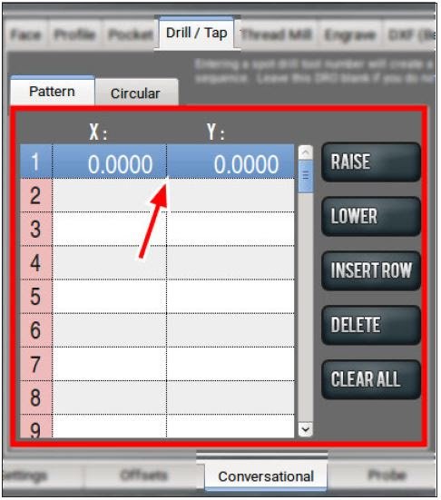

      7. From the Conversational tab, select the Drill/Tap tab.
      8. On the Drill/Tap tab, make sure that the Pattern tab is selected. Then, type the following values into the following DRO fields: a. In the DRO field in the X column of row 1, type 0.0000. Then select the Enter key. b. In the DRO field in the Y column of row 1, type 0.0000. Then select the Enter key.

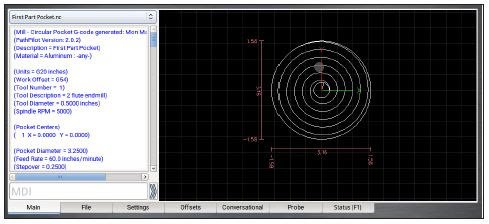

      9. From the Conversational tab, select the Pocket tab.

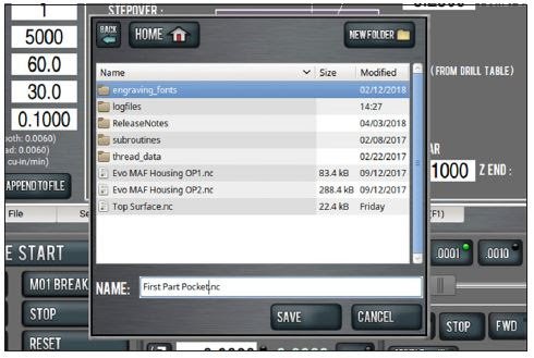

      10. Select Post to File. PathPilot generates the G-code file, and the Save dialog box displays.
      11. From the Save dialog box, specify where on the PathPilot controller to save the G-code file.
      12. Select Save. PathPilot loads the G-code file and opens the Main tab.
Run the Programs
      1. Restrict the speed of the mill so that you can more easily watch the operation running: Set the Maxvel Override slider to 0%.
      2. Select Cycle Start. The spindle begins to rotate, but the tool won't move, because you restricted the speed in Step 1.
      3. Change the value of the Maxvel Override slider to speed up, slow down, or stop the mill. When the tool is close to the part, set the Maxvel Override slider to 0%.
      4. On the Main tab, verify the values in the DRO fields to make sure that they look correct for the current tool position. Then, slowly move the Maxvel Override slider to speed up the mill. For example, if the value in the Z DRO field is 0.2500, the tool should be 1/4 in. above the workpiece.
      5. After the operation is complete, examine the top surface of the workpiece to make sure that the entire pocket has been cut by the end mill.

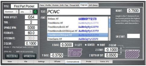

Similar to using conversation for the pocket, we’ll use conversation programming in the PathPilot interface to create engraved text.
      1. From the PathPilot interface, on the Engrave tab, type the following values into the DRO fields, and press Enter on the keyboard after typing each value:
          c. In the Tool DRO field, type 2.
          d. n the Spindle RPM DRO field, type 5000.
          f. In the Z Clear DRO field, type 0.1000.
          g. In the Text DRO field, type PCNC.
          h. In the Height DRO field, type 0.7500.
          i. In the X Base DRO field, type 0.0000.
          j. In the Y Base DRO field, type -0.3750.
          k. In the Z Start DRO field, type -0.1000.
          l. In the Z Depth of Cut DRO field, type 0.0500.
      1. From the Font list, select FreeMonoOblique.ttf.
      2. From the Alignment radio buttons, select Center.

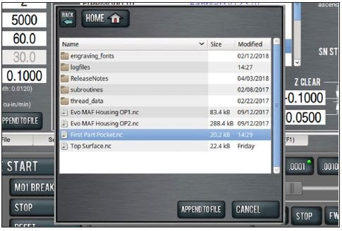

      3. Select Append to File. PathPilot generates the G-code file, and the Append to File dialog box displays.
      4. From the Append to File dialog box, specify to which file you want to add this operation
      5. Select Append to File. PathPilot adds the G-code to the file and opens the Main tab.

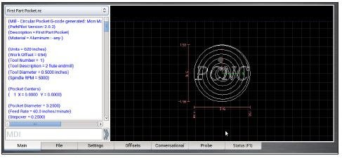

Because we appended the second operation onto the first, the program starts from the beginning — it re-cuts the pocket. To avoid this in the future, you can post the second operation to a separate file.
      1. Select Cycle Start. The spindle begins to rotate, and the tool moves to the beginning of the tool path.
      2. After the operation is complete, put tool 2 (the 1/8 in. end mill) into the spindle.
      3. From the PathPilot interface, in the Tool DRO field, type 2. Then select the Enter key.
      4. Restrict the speed of the mill so that you can more easily watch the operation running: Set the Maxvel Override slider to 0%.
      5. Select Cycle Start. The spindle begins to rotate, and the tool moves to the beginning of the tool path.
      6. Change the value of the Maxvel Override slider to speed up, slow down, or stop the speed of the mill.
      7. After the operation is complete, examine the top surface of the workpiece to make sure that the entire phrase has been engraved by the end mill.
