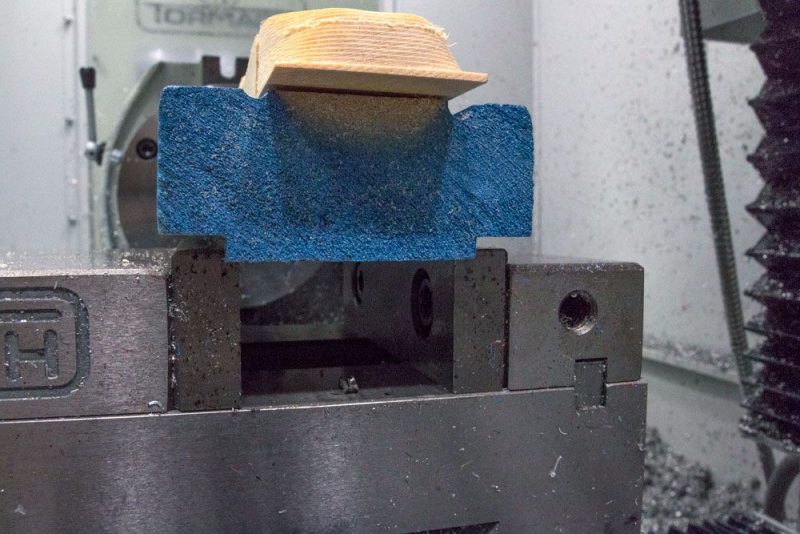

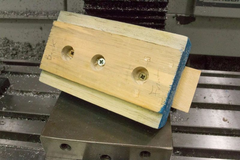

  1. Find a Secure Workholding MethodTo hold the car, I scribed the edge of a piece of pine so there was a straight line to align the official Pinewood Derby Car stock. You could use a marker, but it would have to be quite straight. Measure twice cut once. Then, secure the pinewood block to a workholding block with several screws, being careful to keep them out of the cutting envelope.3.Cutting the CarOnce the the stock is secured to the workholding, we secure the workholding block into a machinist's vise. Load the G-code, or TAP file into the PathPilot controller and find your zeroes with a Haimer or another edgefinder tool - the X, Y zero on this project is at the back left corner of the stock and the Z zero is on top of the stock.
A piece of scrap wood used to help hold the pinewood derby car in place - when milling on a Tormach millA piece of scrap wood used to help hold the pinewood derby car in place - when milling on a Tormach mill

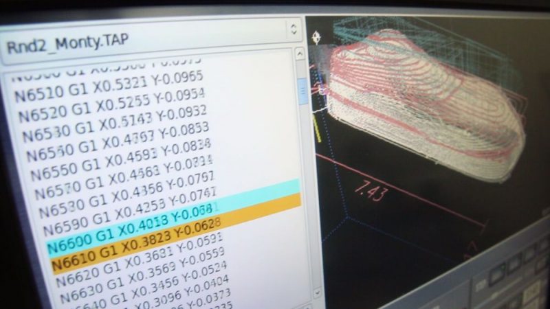

The PathPilot display when creating a Pinewood Derby car on a Tormach millThe PathPilot display when creating a Pinewood Derby car on a Tormach mill

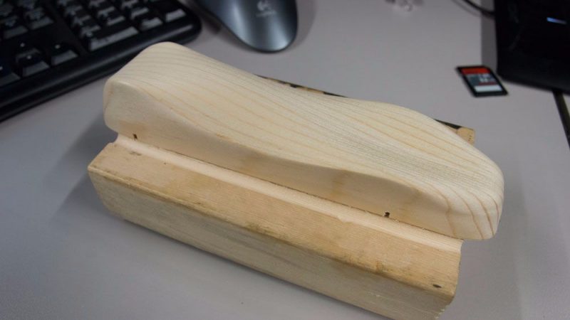

a pinewood derby car that has just been cut on a Tormach milla pinewood derby car that has just been cut on a Tormach mill
