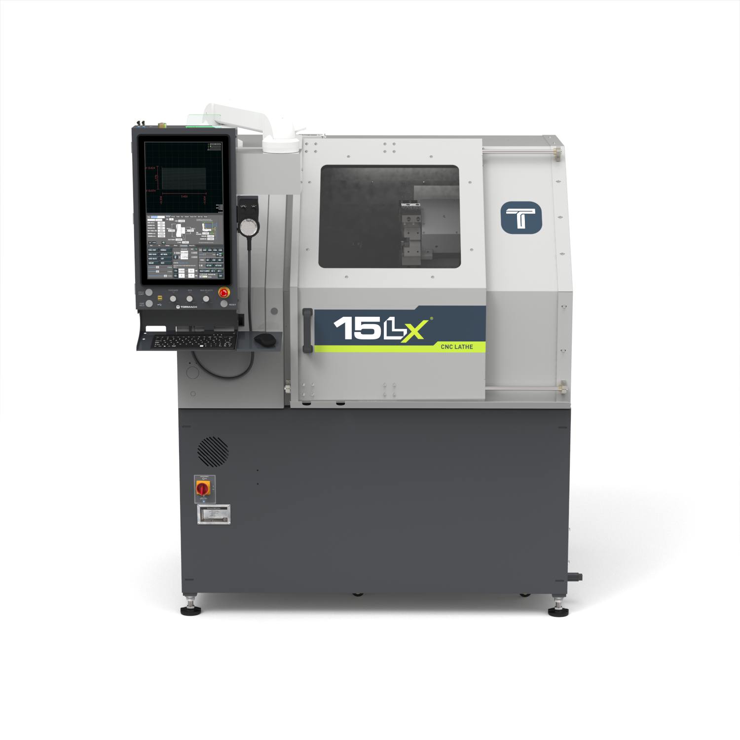

15LX LATHE TECHNICAL SPECIFICATIONS
Spindle
Spindle Power: Continuous: 6 hp (4.5 kW)
- Peak: 10 hp (7.4 kW)
Spindle Speed: Max: 3,500 RPM
Spindle Taper: 5C (With Removable Insert)
Spindle Bore Diameter: 1.53 in. (38.86 mm)
- (With 5C Insert Removed)
Motion
Max Feed Rate:
  • 360 IPM (9.14 m/min)(X)
  • 360 IPM (9.14 m/min)(Z)
EtherCAT Motion System:
  • Closed-Loop
  • True Position
  • High-Performance Servos
Power
Power Required (Primary): 230 Vac Single-Phase*, 30A Breaker
Supplied with NEMA L6-30P plug; requires NEMA L6-30R receptacle
Warranty
1-Year Warranty against defects in material and workmanship.Extended Warranty available.
Machine Footprint: 54.75 in. × 38.12 in. x 68.25 in.(1390 mm × 968 mm x 1733 mm)
Typical System Weight: Gang Tool Lathe: 1631 lbs. / Turret Lathe: 1764 lbs.
Swing Over Bed: 15 in. (381 mm) Diameter
Swing Over Carriage: 6.2 in. (157.5 mm) Diameter
Z-Axis Travel: 14 in. (356 mm)
Optional Accessories
Full Enclosure (Standard)
PathPilot® Touchscreen Operator Console (Standard)
Air-Gun Kit (Standard)
Washdown Kit (Standard)
8-Station Turret (Optional)
Gang Tooling System (Optional)
