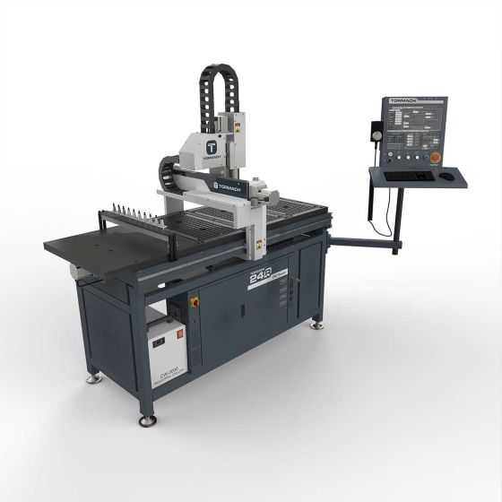

24R CNC ROUTER TECHNICAL SPECIFICATIONS
Travels
X-Axis: 24.75 in. (625 mm)
Y-Axis: 55.75 in. (1415 mm)
Z-Axis: 6.70 in. (170 mm)
Spindle
Spindle Power: 2 hp / 1.5 kW
Spindle Type: Electrospindle
Minimum Speed: 10,000 RPM
Maximum Speed: 24,000 RPM
Cooling: Water-Cooled (Chiller Included)
Spindle Taper: Stock - ER20 / With ATC - ISO20
Thread Machining: Thread Mill
Power Required
24R CNC Router: Single-Phase 115 Vac, 50/60 Hz, 15A breaker
Storm Vacuum Pump for 24R: Single-Phase 220-240 Vac / 20A breaker
Machine Specs
Table Type: Integrated Vacuum Table
Table Size: 26.5 in. x 65 in. (680 mm x 1650 mm)
Gantry Clearance: 6 in. (154 mm)
Machine Footprint: 72 in. × 39 in. (1.8 m × 1 m)
Overall System Height: 76.5 in. (1.9 m)
Typical System Weight: 900 lb (408 kg)
Linear Motion
Axis Motion: Ballscrew and Stepper Driver
Maximum Feed Rate: 200 IPM (5.0 m/min)
Construction
Stand: Welded Steel (Included)
Machine Base: Cast Iron
Gantry: Aluminum
Resolution & Accuracy
Resolution: 0.00025 in. (0.006 mm)
Ball Screw Positional Accuracy: ±0.002 in./ft. (±0.167 mm/m)
Repeatability: ±0.001 in. (±0.02 mm)
Certificate of Inspection: Download Example Here
PATHPILOT® Controller
80GB program memory
Warranty
Assembly
24R CNC Router Assembly is available for $2,995.
