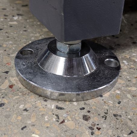

Standard Height Adjustable Machine Foot This product is required for the machine.
More Info In Stock
