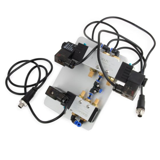

24VDC Solenoid Kit for 4mm Pneumatic Tubing, includes one 5-way center-exhaust solenoid and one 2/4 solenoid
This kit includes two 24VDC solenoid valves with push-to-connect fittings and M12 electrical connectors for plug and play connection to the ZA6 robot outputs and pneumatic accessories. Mounting plate with holes spaced to match threaded PEM fasteners allows you to mount this to the side of the ZA6 electrical cabinet. It is similar to the 39433 24VDC solenoid Kit but one of the solenoid valve is a 5-way valve with center exhaust so that pressure can be relieved/equalized from whatever accessory is attached to it.This product will control any pneumatic device that uses 4mm pneumatic tubing but was specifically designed to work with the Multigrip kit (PN 50960) and the automated sliding door products for Tormach machine tools.
What's in the Box?
  • 2 Solenoid valves mounted to backing plate with PTC fittings and M12 electrical connector wiring harness.
Specifications:
  • Type: One two-position valve, one five-way valve with center exhaust
  • Input voltage: 24VDC±10%
  • Rated power: 3W per valve
  • Pressure:0.15-0.8MPa
  • Working temperature:-20-70℃
  • Waterproof: IP67
