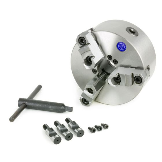

The 3-Jaw Reversible 6 in. Lathe Chuck (D1 Type Direct Mount) is a 3-Jaw Chuck with Reversible Jaws- 6 in. Diameter, D1-4 direct mount
3-Jaw Chuck with reversible jaws.  6.25" Diameter, D1-4 direct mount.
Specifications
  • Diameter: 6.25 in.
  • Thru Hole Size: 1.6 in.
  • Mount: D1-4 (flange not included)
  • (3) 16 mm Cam-lock Studs (M10 x 1 Thread), Hardened
  • Hardened Scroll Plate
  • Maximum 0.003 in. TIR using nominating pinion
  • 0.001" Repeatability using nominating pinion
  • Includes Reversible Jaw set, Chuck Key, and Cam Wrench
  • Max RPM: 2500
