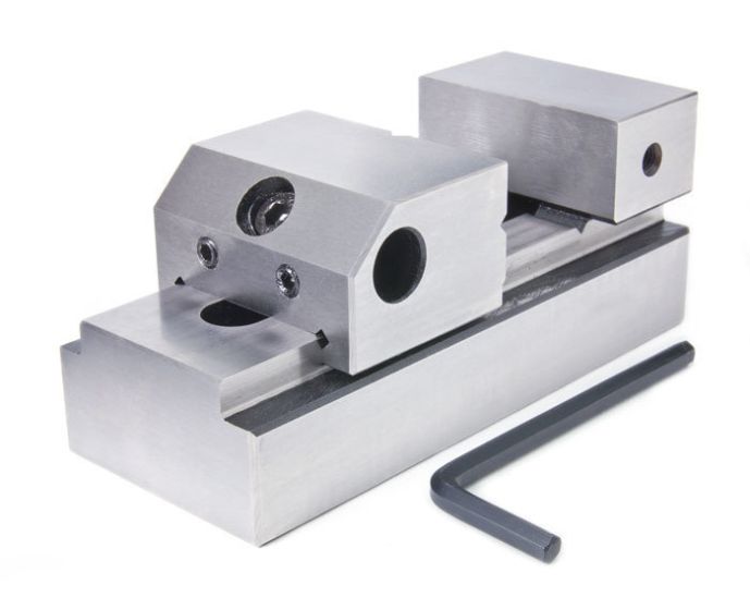

Precision Toolmaker Vise with 45 mm (1.77 in.) jaw width.
Precision Toolmaker Vise. Adjustable pin and spring design for simple and secure clamping of small parts.
  • Hardened Steel Jaws and Bed
  • 45 mm x 20 mm Jaw Size
  • 50 mm Max Jaw Opening
  • 110 mm Overall Length
  • Fixed Jaw has Tapped Hole (M5)
  • Vise bed heights are held to a .0004" (.01mm) height tolerance
Tormach Toolmaker vises all follow Industry Standards for precision; Hardness HRC 58-62, Parallelism .00005 in./1 in., Squareness 0.0002
NOTE: While all of our vises go through a certification process Tormach cannot guarantee that the any two vises will be matched to one another and recommends shimming when using multiple vises on your machine.
