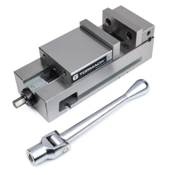

4 in. CNC Vise. Compact Vise with replaceable jaw plates, includes bridge clamp set.
Features:
A versatile and compact 4 in. CNC Vise that can be mounted upright or on either side.
- Precision ground cast iron construction
- Lockdown design eliminates "jaw lift" of moveable jaw.
- 3/8-16 UNC tapped holes accept standard 4 in. jaw plates for inside or outside jaw placement.
- 7/16-14 tapped hole located on fixed jaw for attaching a workstop, etc.
- Generous clamping slots allow for secure and versatile placement of vise on table
- .390 in. (10 mm) keyway slots on bottom face with 10-32 UNF tapped holes (x6). Can be used for vise keys (optional, not included) or for attaching vise to fixture plate, etc.
- Made in Taiwan
- Vise bed heights are held to a .0004" (.01mm) height tolerance
