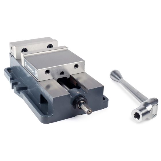

5" Machinist Vise, Precision Angle Lock / Plated Handle & Kit
Secure stock and work material with this cast-iron CNC vise. You can quickly mount the vise with D-style side flanges into your machine’s T-slot, and its keyed stationary jaw provides a rigid backstop.
Features:
  • 5 in. (127 mm) jaw width
  • Constructed with 80,000 psi (550,000 kPa) ductile cast iron
  • Flame-hardened vise bed
  • Non-lifting moveable jaw design
  • Compatible with industry-standard jaw plates
  • 7/16-14 in. hole in fixed jaw for workstop (optional; sold separately)
  • 1/2-13 in. holes on bottom for anchoring stationary jaw
  • All machined surfaces are square and parallel within 0.001 in. (0.025 mm)
  • High-quality powder coat paint on non-critical surfaces
  • Machined steel handle
  • Machined slots for vise keys (optional; sold separately)
  • Vise bed heights are held to a .0004" (.01mm) height tolerance
