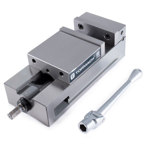

The 6 in. (150mm) CNC Vise is premium vise that provides secure workholding for a wide range of jobs. Precision ground surfaces on both sides to allow side-mounting for high-density workholding applications. Compatible with CarveSmart™ dovetailed quick-change jaws as well as 1/2 in. -13 bolt-on jaws in a 3.875 in. x 0.9375 in. bolt hole pattern.
Secure stock and work material with this versatile CNC vise. Its compact design prevents the movable jaw from lifting as you’re tightening it, and the keyed stationary jaw provides a rigid backstop. You can mount the interchangeable jaw plates in inside or outside jaw positions, and use a bridge clamp for side-by-side, compact mounting of multiple vises.
Compatibility:
  • 1500MX
What's In the Box?
  • Vise
  • Premium electroplated vise handle
  • 4 toe clamps, T-nuts, socket-head cap screw mounting hardware
  • 2 vise keys with fasteners
Specifications:
  • 6 in. jaw opening
  • Constructed with 80,000 psi (550 MPa) ductile cast iron
  • Compatible with industry-standard jaw plates
  • 7/16-14 in. hole in fixed jaw for workstop (optional; not included)
  • M8 holes on bottom for anchoring
  • Precision ground on four sides to within 0.01mm. Can use two vises together without need for a ‘matched pair’
  • Concealed lead screw
  • Adjustable thrust washer
  • Machined slots for vise keys
  • Industry standard jaw size and hole spacing
  • Made in Taiwan
NOTE: While all of our vises go through a certification process Tormach cannot guarantee that the any two vises will be matched to one another and recommends shimming when using multiple vises on your machine.
NOTE: If you need a replacement jaw plate set screw for your 6 in. CNC Vise, You will need a screw with the following specifications: 1/2 in. - 13 x 1 in. long socket head cap screw, Material Alloy Steel
