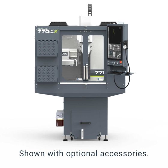

770MX TECHNICAL SPECIFICATIONS
Travels
X-Axis: 14 in. (356 mm)
Y-Axis: 7.5 in. (191 mm)
Z-Axis: 13.25 in. (337 mm)
Spindle
Spindle Power: 2 hp / 1.49 kW
Peak Spindle Power: 4.5 hp / 3.35 kW
Maximum Speed: 10,000 RPM
Spindle Taper: BT30
Tapping & Threading: Rigid Tapping, Tension/Compression, Thread Mill
Maximum Feed Rate
X- and Y-Axis: 450 IPM (11.4 m/min)
Z-Axis: 420 IPM (10.6 m/min)
Power and Air
Power Required: Single-Phase, 230 VAC*, 20A breaker
Air Required: 90-120 psi
Frame
Frame and Table: Cast iron frame and table, with hand-scraped hydrodynamic ways and tapered adjustment gibs.
Table Size: 26 in. × 8 in. (660 mm x 203 mm)
Spindle Nose to Table Max Clearance: 13.75 in. (349 mm)
Spindle Centerline to Machine Column: 8.6 in. (218 mm)
Typical System Footprint: 56 in. × 48.5 in. (1422 mm x 1232 mm)
Overall System Height: 88 in. (2235 mm)
Typical System Weight (Factory Assembled): 1500 lbs (681 kg)
EtherCAT Motion System: Absolute Encoder, EtherCAT Servos
