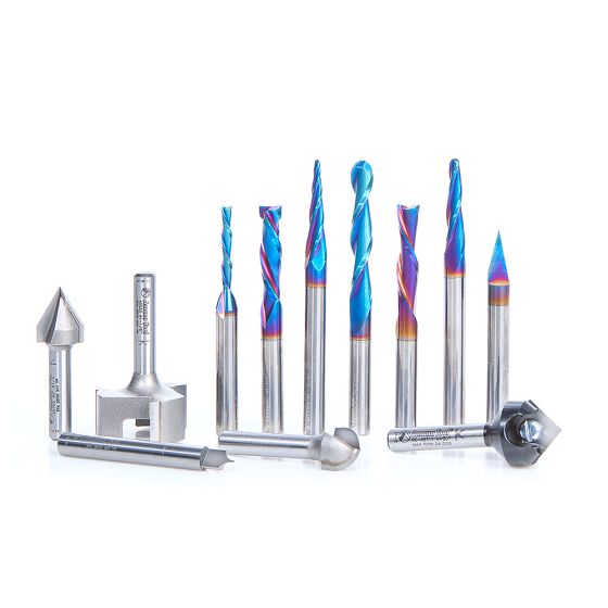

This is a premium 12-piece CNC router bit set designed for general purpose use on wood, plastics, composites, and similar materials. This kit is an excellent starter or upgrade set for educational, prototyping, and hobbyist CNC applications.
Each tool is manufactured by Amana Tool, a leader in CNC cutting technology, and comes packed in a durable Tanos Systainer plastic case for easy storage and transport. The AMS-259 kit is ideal for signmaking, cabinetry, and general CNC routing tasks, and is supported by pre-configured tool libraries in Fusion 360 and Vectric for fast, reliable CAM programming.
Note: This kit is not recommended for aluminum or non-ferrous metal cutting. For aluminum, a dedicated kit is required.

| Tool Number | Description | Qty |
| 56125 | Solid Carbide Point Cutting Roundover Router Bit, 1/8 Radius x 1/4 Dia x 5/16 x 1/4 Shank | 1 |
| RC-45711 | In-Tech Insert Carbide V Groove SHK Single Flute Router Bit, 90 Deg x 11/16 D x 21/64 CH x 1/4 Inch | 1 |
| 45910 | Carbide Tipped Core Box Router Bit, 1/4 Radius x 1/2 Dia x 3/8 x 1/4 Inch Shank | 1 |
| 45705 | Carbide Tipped V-Groove Router Bit, 60 Deg x 1/2 Dia x 7/16 x 1/4 Inch Shank | 1 |
| 46415-K | Solid Carbide Spektra™ Extreme Tool Life Coated Spiral Plunge Router Bit, 1/4 Dia x 1 x 1/4 Inch Shank | 1 |
| 46350-K | Solid Carbide Spektra™ Extreme Tool Life Coated Mortise Compression Spiral Router Bit, 1/4 Dia x 1 Inch x 1/4 Shank | 1 |
| 46294-K | Solid Carbide Spektra™ Extreme Tool Life Coated Spiral Plunge Router Bit, 1/4 Dia x 3/4 x 1/4 Inch Shank | 1 |
| 46286-K | 2D and 3D Carving 3.6 Deg Tapered Angle Ball Solid Carbide Up-Cut Spiral Spektra™ Extreme Tool Life Coated Router Bit, Tip 1/8 Dia x 1/16 Radius x 1 x 1/4 Shank x 3 Inch Long x 3 Flute | 1 |
| 46282-K | 2D and 3D Carving 0.10 Deg Straight Angle Ball Tip Carbide Spektra™ Extreme Tool Life Coated Router Bit, 1/4 Dia x 1/8 Radius x 1-1/2 x 1/4 Shank x 3 Inch Long x 2 Flute Solid | 1 |
| 46225-K | Solid Carbide Spektra™ Extreme Tool Life Coated Spiral Plunge Router Bit, 1/8 Dia x 13/16 x 1/4 Inch Shank | 1 |
| 45771-K | Solid Carbide 30 Degree Engraving Signmaking Spektra™ Extreme Tool Life Coated Router Bit, 0.005 Tip Width x 1/4 Inch Shank | 1 |
| 45525 | Carbide Tipped Spoilboard Surfacing, Rabbeting, Flycutter, Slab Leveler, Surface Planer & Flattening Router Bit, 1-1/8 Dia x 1/2 x 1/4 Inch Shank | 1 |
