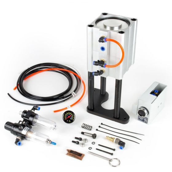

Power drawbar kit for customers installing a BT30 upgrade kit on M+ machines who do not already own a TTS power drawbar kit. – This kit is not needed for new MX machines.
Features:
  • Floating pneumatic cylinder unclamps tools without stressing spindle bearings
  • Included filter-regulator-lubricator (FRL) unit cleans and conditions shop air for extended seal life
  • Easy installation kit has the drawbar up and running in minutes
  • Some assembly required.
Compatibility
  • 1100M+ with BT30 Spindle Upgrade
  • 770M+ with BT30 Spindle Upgrade
  • BT30 tools
Requirements
  • 90 psi to 120 psi (620 kPa to 840 kPa) compressed air source
What's In the Box?
  • Cylinder assembly
  • Valve assembly
  • Filter-regulator-lubricator (FRL) unit
  • Installation tools, tubing, and hardware
