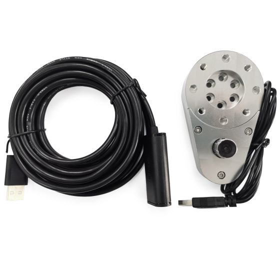

ZA6 robot flange with camera and USB extension cable.
  • Resolution: 1 Megapixel (MP)
  • USB 2.0
  • USB extension length: 16.4 ft. (5m)
Specifications:
  • Flange match standard: ISO_9409-1-50-4-M6
  • Camera Model: JY002402001
  • Circuit board size: 11.02 x 11.02 in. (28 x 28cm)
  • Lens: 60 degree
  • USB 2.0
  • Focus mode: manual focus
  • Imaging distance: 2cm-infinite
  • USB cable length: 3.93 ft. (1.2m)
  • Frame rate: 720P@40fps/VGA@80fps , 720P@40fps/VGA@90fps
  • Output image format: YUV /MJPEG
  • Photographic processing: Adjustable brightness, contrast, hue, saturation, clarity, gamma, white balance
  • Working temperature: '-20C ~70C
  • Working voltage: 5V
  • System compatibility: Win7 Win8 Win XP SP2, Vista free drive ; Support Linux and Android
  • Active size: 1/4'
  • Power: <0.7W
  • Frequency: 50Hz/60Hz
  • Default window: 1280X720
  • Dynamic range: 90dB
