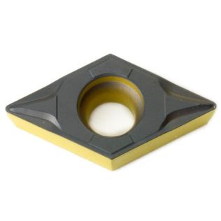

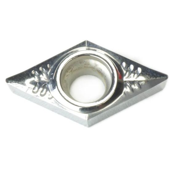

The Carbide Insert: DCGT 3(2.5)1 is a positive rake carbide lathe insert that is recommended for Aluminum
Package of 10 DCGT 3(2.5)1 Carbide Turning Inserts. Positive Rake Insert with Chipbreaker. Recommended for aluminum.
  • Designation (ANSI/ISO): DCGT 3(2.5)1 / DCGT 11T304
  • Shape: 55° Rhombus (D)
  • Clearance Angle: 7° (C)
  • Tolerance: Class G (G)
  • Type: Single-Sided (T)
  • Insert I.C.: 3/8 in. (3)
  • Thickness: 0.156 in. (2.5)
  • Corner Radius: 0.016 in. (1)
  • Grade (ISO): N20
  • Coating: Polished
  • Application: Aluminum
