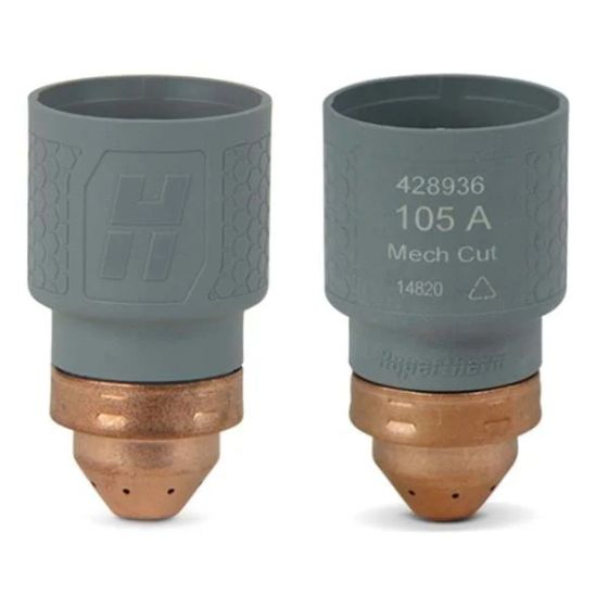

Hypertherm cartridge: SmartSYNC or adapter 105 A mechanized cutting
Hypertherm Part Number: 428936
If using with a non-SYNC plasma source PN 51736 Hypertherm cartridge adapter is needed.
105 A mechanized cartridges provide optimal production performance when cutting within the thickness range of 10 mm (3/8″) to 20 mm (3/4″) thick. Exceeding optimal thickness range can result in decreases in speed and cut quality. To maximize cartridge life and performance select the correct amperage cartridge for the workpiece you are cutting.
105 A mechanized cutting cartridges are compatible with:
  • SmartSYNC™ torches for the Powermax105 SYNC™ systems.
  • Duramax® torches using a torch adapter* for Powermax105® systems.
  • Mechanized cartridges can also be used on hand torches if cutting with a stand-off is desired.
