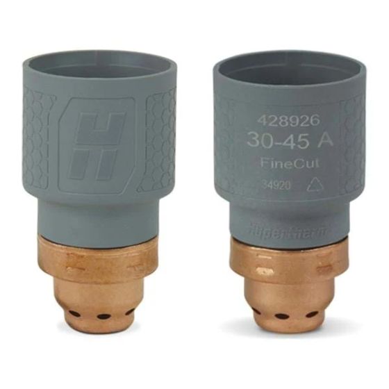

Hypertherm cartridge: SmartSYNC or adapter 30-45A mechanized FineCut
$64.95
51684
Only 1 left
Hypertherm Part Number: 428926
If using with a non-SYNC plasma source PN 51736 Hypertherm cartridge adapter is needed.
FineCut® cartridges produce a narrower kerf on thin mild steel and stainless steel up to 3 mm (10 gauge) which is ideal for fine detail cutting. To maximize cartridge life and performance it is important to select the cartridge that is optimized for the workpiece you are cutting.
30–45A FineCut – mechanized cartridges are compatible with:
- SmartSYNC torches for the Powermax65/85/105 SYNC™ systems
- Duramax® torches using a torch adapter* for Powermax45® XP/65/85/105 systems
