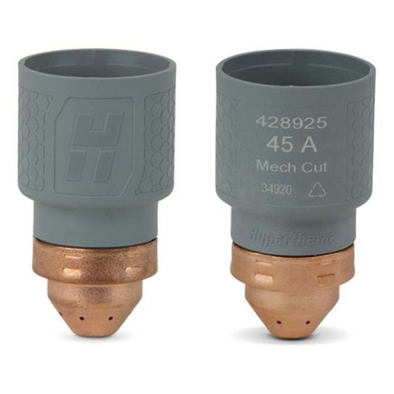

Hypertherm cartridge: SmartSYNC or adapter 45A mechanized cutting
Hypertherm Part Number: 428925
If using with a non-SYNC plasma source PN 51736 Hypertherm cartridge adapter is needed.
45A mechanized cartridges provide optimal production performance when cutting within the thickness range of 3 mm (1/8″) to 6 mm (1/4″) thick. Exceeding optimal thickness range can result in decreases in speed and cut quality. To maximize cartridge life and performance select the correct amperage cartridge for the workpiece you are cutting.
45A mechanized cutting cartridges are compatible with:
- SmartSYNC™ torches for the Powermax65/85/105 SYNC™ systems
- Duramax® torches using a torch adapter* for Powermax45® XP/65/85/105 systems.
- Mechanized cartridges can also be used on hand torches if cutting with a stand-off is desired.
