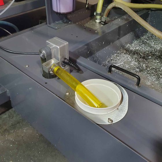

The Oil Skimmer Kit for 1500MX extends coolant life by removing tramp oil from the coolant tank
Note: This product requires 110 VAC @ 60 Hz power and will not operate on 50 Hz systems.
The Oil Skimmer Kit for 1500MX extends coolant life by removing tramp oil from the coolant tank. Once removed, the tramp oil is collected in a container for easy disposal. Removing floating surface oils also extends cutting tool life and creates a cleaner shop environment reducing the potential for smoke and odors. Features include:
  • 3/4 in. (19 mm) Kevlar-reinforced, toothed belt made of polyurethane for durability and chemical resistance
  • Low power consumption for minimal electricity costs
Some assembly required. Runs on grounded, external 115VAC outlet.
Compatibility
  • 1500MX
  • This product will not work on 50Hz electrical grids, 60Hz is required.
