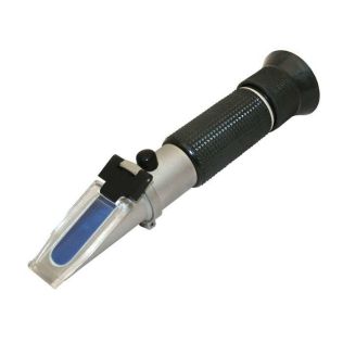

- Qualichem recommends a 7 - 10% concentration for machining operations.
- We recommend a refractometer (such as PN 31366 Portable Refractometer - Coolant Tester) to measure dilution.
