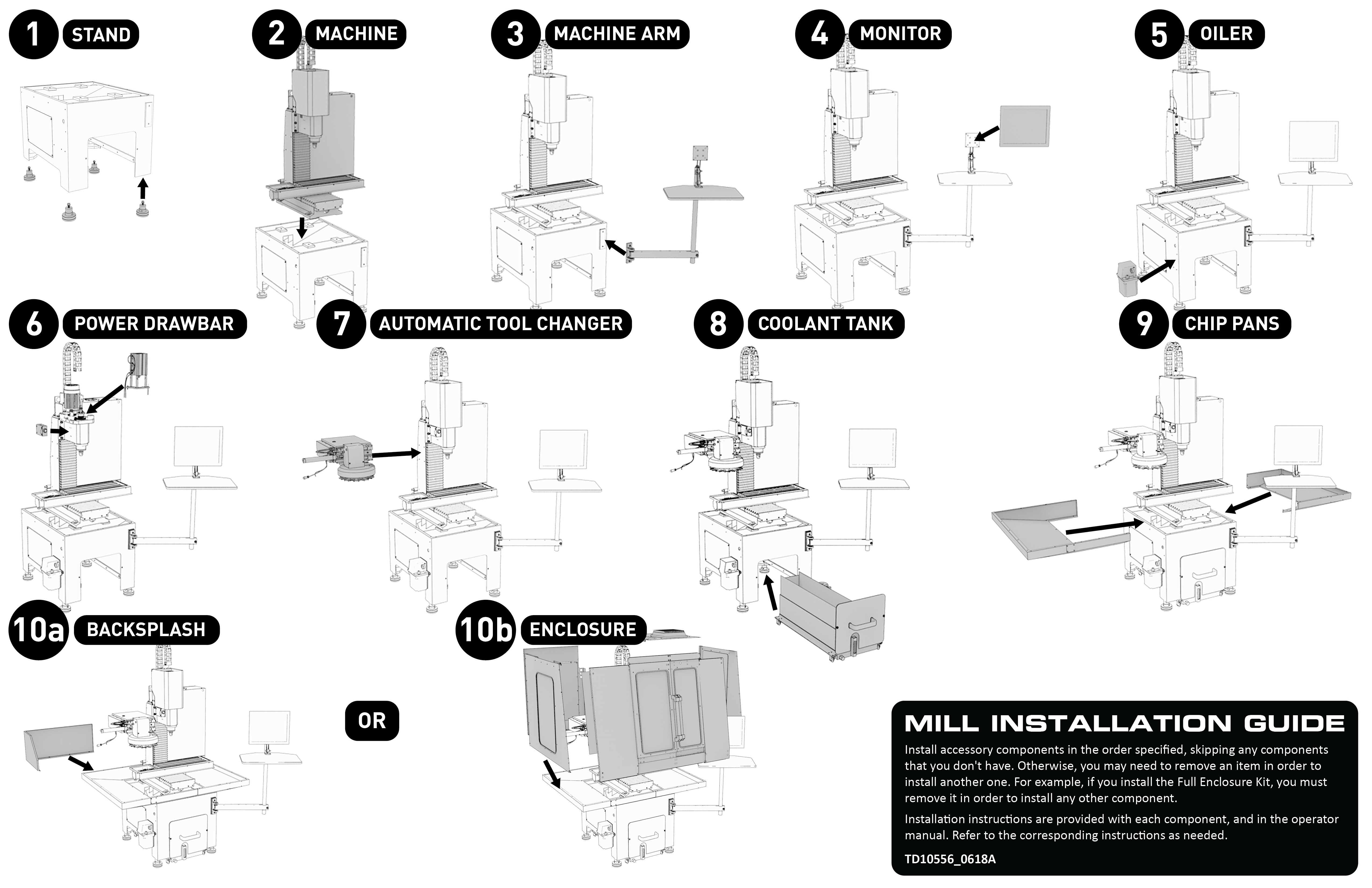

770M INSTALLATION
The following list of documents and videos are intended to assist with installation of your 770M mill. The items are presented in the recommended order of installation. Tormach strongly urges customers to follow this sequence when installing your equipment in order to avoid installation conflicts. Please note that some of the installation instructions/videos may not be applicable for your particular set of equipment accessories. (Installation videos are coming soon.)
INSTALLATION PLANNING DOCUMENTS
INSTALLATION AND SETUP
ACCESSORIES INSTALLATION
