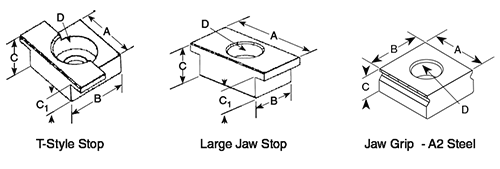

Talongrip™ Steel Vise Jaw Set allows for aggressive work holding on a range of machining applications while clamping on as little as 0.060" (1.5mm). This bolt on system is adjustable and ideal for small lot sizes, difficult applications, and R&D work. This kit is compatible with 4 in and 5 in. vises.
COMPATIBLE WITH TORMACH 4in. and 5 in. VISES
STEEL VISE JAW SET

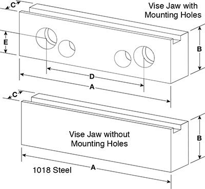

| Vise (metric) | 4 in. /6 in. (100mm/150mm) |
| A (metric) | 6.0 in. (150 mm) |
| B (metric) | 1.88 in. (47.75 mm) |
| C (metric) | 1.0 in. (25.4 mm) |
| D (metric) | 2.5 in. / 3.125 in. (63.5 mm/ 79.375 mm) |
| E (metric) | .688 in. / .8 in. (17.47 mm / 20.32 mm) |
