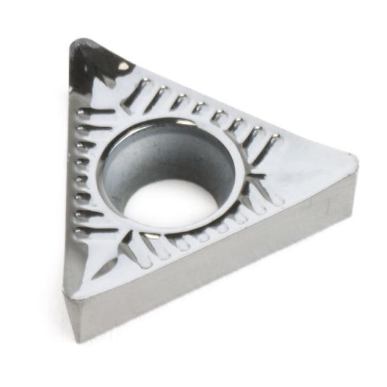

TCGT 3(2.5)2 Insert 10-Pack
$82.95
35019
0.3 lbs.
The TCGT 3(2.5)2 Insert is a positive insert with chipbreaker that is recommended for Aluminum machining
Package of 10 TCGT 3(2.5)2 Carbide Turning Inserts. Positive Insert with Chipbreaker. Recommended for Aluminum Roughing.
- Designation: TCGT 3(2.5)2
- Shape: 60° Triangle (T)
- Clearance Angle: 7° (C)
- Tolerance: Class G (G)
- Type: Single-Sided (T)
- Insert I.C.:3/8 in. (3)
- Thickness: 0.156 in. (2.5)
- Corner Radius: 0.031 in. (2)
- Grade (ISO): N20
- Coating: Polished
- Chipbreaker: General Purpose
- Application: Aluminum
