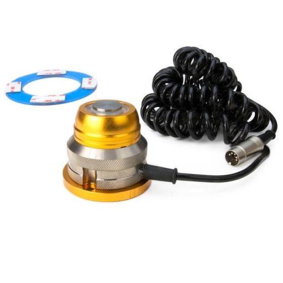

The electronic tool setter for the 24R can be used to quickly and accurately measure tool lengths and work offsets on the 24R. Compared to eyeballing the tool length or using solid aluminum puck, the 24R ETS simplifies tool changes and makes running multiple tools on the same job much easier and more accurate.
- Repeatability: 0.0008 in. (0.02mm)
- Sense Logic - Normally closed
- Over travel - 5mm
- Requirements - PathPilot controller
What's In the Box?
- Tool setter home ring
