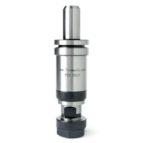

The TTS ER Collet Tap Holder: ER20 is a TTS-ER20 clutchless Tension/Compression tapping head
ER collets range in size from 3/64 in. - 1/2 in. (1 mm - 13 mm)
- Fits all ER20 collets
- Alloy Steel TTS Toolholder
- Outside Diameter: 1.34 in. (34 mm)
- Installed Height: 4.4 in. (112 mm)
- Thread: M25 x 1.5
- Includes ER20 Collet Nut
- Approximately Float: 0.75 in.
Note: Not compatible with PCNC 440 mills.
