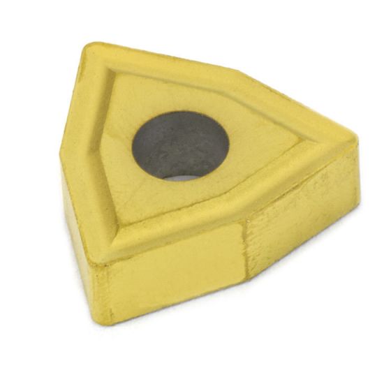

The WNMG 432 Insert is a negative insert with chipbreaker that is recommended for Steel Roughing
Package of 10 WNMG 432 Carbide Turning Insert. Negative Insert with chipbreaker. Recommended for Steel Roughing.
  • Designation: WNMG 432
  • Shape: 80° Trigon (W)
  • Clearance Angle: 0° (N)
  • Tolerance: Class M (M)
  • Type: Double-Sided (G)
  • Insert I.C.: 1/2" (4)
  • Thickness: 0.1875" (3)
  • Corner Radius: 0.031" (2)
  • Grade (ANSI/ISO): C6/P20
  • Coating: TiN
  • Chipbreaker: Roughing
  • Application: Steel
