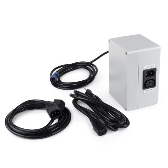

The xsTECH Pro 120V Contactor Box (PN: 53670) is an external relay interface designed for the xsTECH PRO desktop CNC system. It enables safe, reliable switching of 120VAC power to control external devices such as shop vacuums, dust collectors, or other 120V accessories. Each xsTECH PRO can use up to two contactor boxes for flexible automation and accessory control
Key Features
  • 120VAC Relay Switching: Provides isolated, dry-contact relay switching for 120VAC circuits—ideal for controlling dust collection, vacuum, or other shop equipment.
  • Plug-and-Play Integration: Pre-wired and ready to use with the xsTECH PRO; connects via standard 4-pin CPC pigtail carrying 24VDC signal to the 120VAC contactor relay.
  • Industrial-Grade Components: CE and UL-listed relay contactor, robust plastic enclosure, and noise suppressor for safety and reliability.
  • Compact & Durable: Weighs 2.65 lbs, with a small footprint (9 x 5.25 x 6.5 in) for easy placement near the machine or accessory.
  • Flexible Deployment: Cables are long enough to sit on the floor when plugged in at table height. Future versions can be adapted for 230V operation.
Benefits
  • Enables Automation: Required for controlling dust collection, vacuum, and other 120V accessories from the xsTECH PRO.
  • Safe & Reliable: Provides electrical isolation and robust switching for critical shop equipment.
  • Easy to Deploy: No special wiring or configuration required—simply connect and use.
What's in the Box?
  • 1x xsTECH Pro 120V Contactor Box (assembled)
  • Relay contactor (24VDC coil, 120VAC switching, DPST preferred, 15A rating)
  • Plastic enclosure with cord grip
  • Noise suppressor (550 VAC 0.1MFD)
  • Flyback diode for relay protection
  • 4-pin connector for 24V coil voltage
  • 2-conductor cable (6 ft)
  • IEC inlet cable (6 ft, NEMA 5-15P to IEC C13)
  • IEC outlet cable (6 ft, IEC C14 to NEMA 5-15R)
  • IEC inlet/outlet
