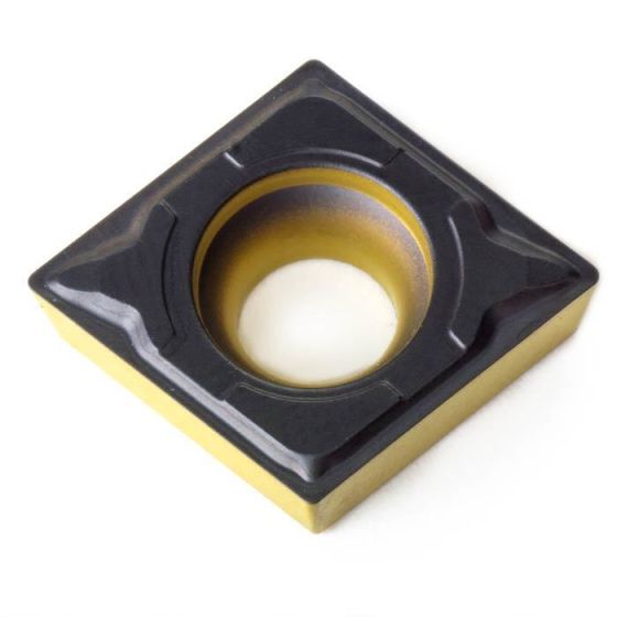

The CCMT 431 Insertis a positive insert with chipbreaker that is recommended for steel machining
Package of 10 CCMT 431 Carbide Turning Insert. Positive Insert with Chipbreaker. Recommended for Steel.
  • Designation: CCMT 431
  • Shape: 80° Rhombus (C)
  • Clearance Angle: 7° (C)
  • Tolerance: Class M (M)
  • Type: Single-Sided (T)
  • Insert I.C.: 1/2 in. (4)
  • Thickness: 0.1875 in. (3)
  • Corner Radius: 0.016 in. (1)
  • Grade (ISO): P5
  • Coating: CVD Al2O3/TiCN
  • Application: Steel
