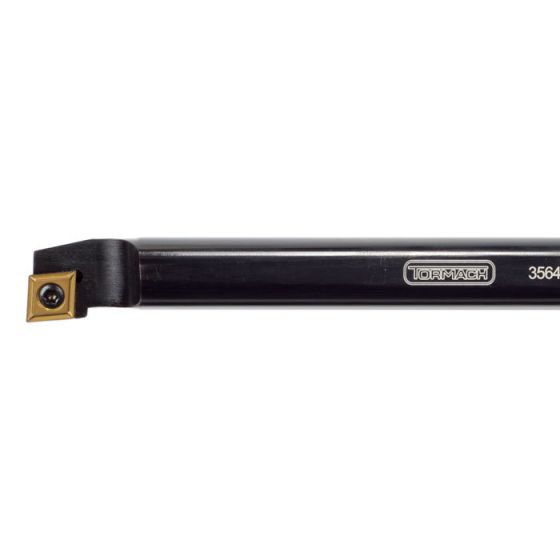

Right Hand Boring Bar - S12S-SCLCR-4
Right Hand Boring Bar. Includes wrenches and (1) insert.
- Designation: S12S-SCLCR-4
- Shank: Steel (S)
- Bar Diameter: 0.750 in. (12)
- Tool Length: 10.0 in. (S)
- Clamping System: Screw (S)
- Insert Shape: 80° Rhombus (C)
- Approach Angle: 95° (L)
- Clearance Angle: 7° (C)
- Hand: Right (R)
- Insert I.C.: 1/2 in. (4)
