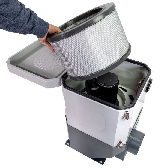

Mist Collector compatible with 1500MX mill.
Mist collection helps keep the air in the shop clean and clear from atomized coolant. Our mist collection system condenses the vaporized liquid and drains it back into your system. The system uses both a stainless steel strainer as well as a particle filter to keep the air clean.
Features:
  • Powerful centrifugal fan quickly pulls the mist and atomized oil out of the machine enclosure
  • 2 Stage filtration system
  • Stainless bottom filter condenses coolant mist and oil and drains it back into the coolant system
  • Secondary internal filter catches small particle and fumes
  • Pressure gauge indicates the internal filter status
  • Motor provides low noise operation with less vibration and a long lifetime
  • Manually controlled power via a simple push-button switch
  • Tool free top filter replacement
  • Washable, stainless steel filter
What's in the box:
  • Mist collector with standard filter
  • Duct flange
  • Duct (3m)
  • Oil return tube
  • Meter
  • Power switch
Specifications:
  • 395mm x 400mm x 650mm
  • 1/2 HP motor
  • 420 cfm air flow
  • Intake dimension 150mm
  • Requires 220V at 2.5A (10A breaker recommended)
  • 65 dB when running
  • 36 kg
