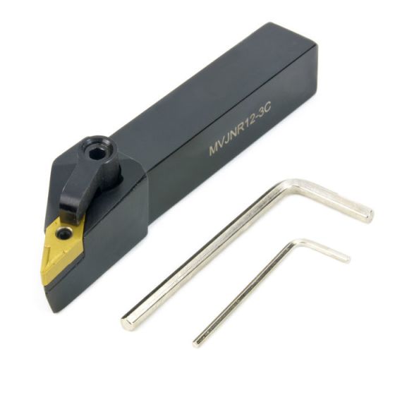

Right Hand Turning/Facing Tool - MVJNR 12-3C
Right Hand Turning/Facing Tool. Includes wrenches and (1) insert.
- Designation: MVJNR 12-3C
- Insert Retention: Multi-Lock Type (M)
- Insert Shape: 35° Rhombus (V)
- Approach Angle: 93° (J)
- Clearance Angle: 0° (N)
- Hand: Right (R)
- Shank Size: 0.750 in. (12)
- Insert I.C.: 3/8 in. (3)
- Tool Length: 5.0 in. (C)
