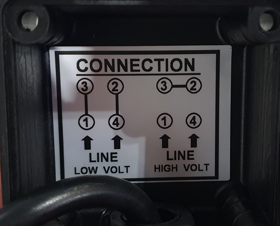

1. Because the coolant pump is dual voltage, you must verify that the motor strapping is correct before you install it:
- a. Loosen the water-tight connector that’s secured to the junction box. Then, slip it down the cable.
- b. Remove the access cover on the coolant pump, and then identify the jumper configuration diagram.
- c. Verify that the jumpers are in the correct configuration (115 Vac/low volt) for your installation. If necessary, adjust the configuration.
- d. Replace the access cover on the coolant pump.
- e. Tighten the water-tight connector snug back onto the junction box.
