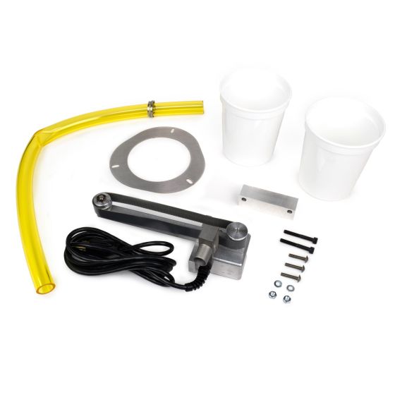

Oil Skimmer Kit for 1100M/1100MX, 770M/770MX, and PCNC 440
$365.00
39298
3.7 lbs.
Currently out of stock
The Oil Skimmer Kit for 1100M / 1100MX, 770M / 770MX, and PCNC 440 extends coolant life by removing tramp oil from the coolant tank
Note: This product requires 110 VAC @ 60 Hz power and will not operate on 50 Hz systems.
The Oil Skimmer Kit for 1100M / 1100MX, 770M / 770MX, and PCNC 440 extends coolant life by removing tramp oil from the coolant tank. Once removed, the tramp oil is collected in a container for easy disposal. Removing floating surface oils also extends cutting tool life and creates a cleaner shop environment reducing the potential for smoke and odors. Features include:
  • 3/4 in. (19 mm) Kevlar-reinforced, toothed belt made of polyurethane for durability and chemical resistance
  • Low power consumption for minimal electricity costs
Some assembly required. Runs on grounded, external 115VAC outlet.
Compatibility
  • 1100M / 1100MX
  • 770M / 770MX
  • PCNC 440
  • This product will not work on 50Hz electrical grids, 60Hz is required.
Specifications
Container Storage Capacity
38.5 oz (1.1 L)
Voltage
115 Vac
Cord Length
8 feet
What's In the Box?
In addition to the oil skimmer, items include:
  • Installation instructions
  • Mounting hardware
  • Tramp oil collection container
