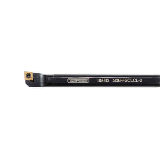

Left Hand Boring Bar - S06H-SCLCL-2
Left Hand Boring Bar. Includes wrenches and (1) insert.
- Designation: S06H-SCLCL-2
- Shank: Steel (S)
- Bar Diameter: 0.375 in. (06)
- Tool Length: 4.0 in. (H)
- Clamping System: Screw (S)
- Insert Shape: 80° Rhombus (C)
- Approach Angle: 95° (L)
- Clearance Angle: 7° (C)
- Hand: Left (L)
- Insert I.C.: 1/4 in. (2)
