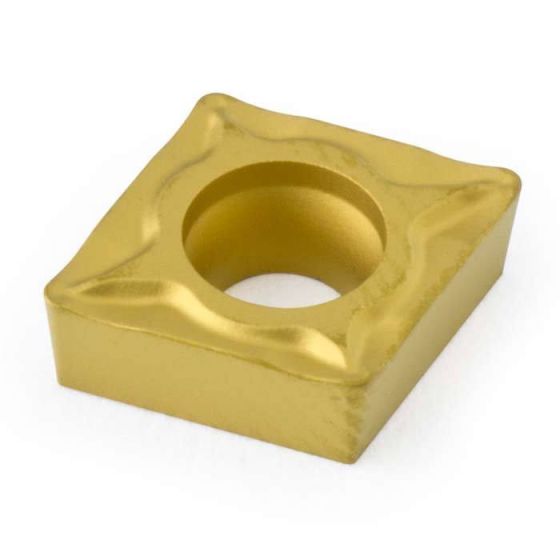

The CCMT 2(1.5)1 Insert is a positive lathe insert with chipbreaker recommended for semi-finishing of steel
Package of 10 Lathe Inserts
  • ISO Code/Manu. Code: CCMT 06024-HM
  • ANSI Code: CCMT2(1.5)1-HM
  • Type: Cemented Carbide
  • Grade: YBC251
  • Comparable ISO Grade: P10-P30
  • Surface Prep: CVD
  • Shape: 80 Rhombus (C)
  • Clearance Angle: 7 (C)
  • Tolerance: Class M (M)
  • Type: Single Sided (T)
  • Insert I.C.: .250 in. (2)
  • Thickness: .094 in. (1.5)
  • Corner Radius: .016 in. (1)
Notes: Lathe, General Purpose
