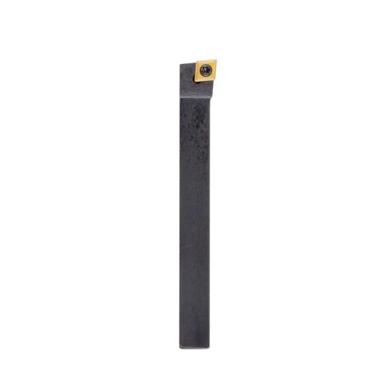

Left Hand Turning/Facing Tool - SCLCL 06-2J
Left Hand Turning/Facing Tool. Includes wrenches and (1) insert.
- Designation: SCLCL 06-2J
- Insert Shape: 80° (C)
- Approach Angle: 95° (L)
- Clearance Angle: 7° (C)
- Hand: Left (L)
- Shank Size: 0.375 in. (06)
- Insert I.C.: 1/4 in. (2)
- Tool Length: 3.5 in. (J)
