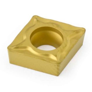

The Carbide Insert: CCGT 2(1.5)1 iS A Positive rake carbide lathe insert that is recommended for aluminum
Package of 10 CCGT 2(1.5)1 Carbide Turning Inserts. Positive Rake Insert with Chipbreaker. Recommended for Aluminum.
  • Designation: CCGT 2(1.5)1
  • Shape: 80° Rhombus (C)
  • Clearance Angle: 7° (C)
  • Tolerance: Class G (G)
  • Type: Single-Sided (T)
  • Insert I.C.: 1/4 in. (2)
  • Thickness: 0.094 in. (1.5)
  • Corner Radius: 0.016 in. (1)
  • Grade (ISO): N20
  • Coating: Polished
  • Application: Aluminum
