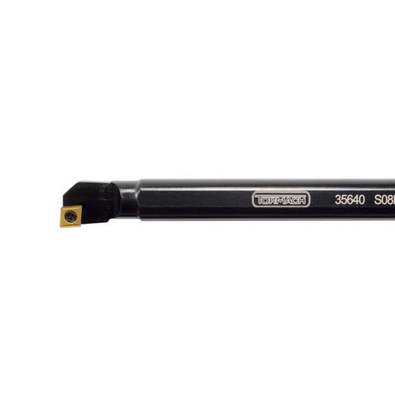

Right Hand Boring Bar - S08M-SCLCR-2
Right Hand Boring Bar. Includes wrenches and (1) insert.
- Designation: S08M-SCLCR-2
- Shank: Steel (S)
- Bar Diameter: 0.500 in. (08)
- Tool Length: 6.0 in. (M)
- Clamping System: Screw (S)
- Insert Shape: 80° Rhombus (C)
- Approach Angle: 95° (L)
- Clearance Angle: 7° (C)
- Hand: Right (R)
- Insert I.C.: 1/4 in. (2)
